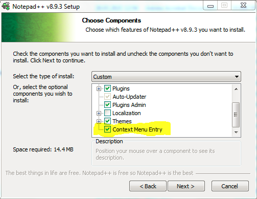

            • MarkusBodenseeM Offline
              MarkusBodensee
              And please don’t forget the easiest solution, just uncheck the option to install the Context Menu Entry during Notepad++ installation.
