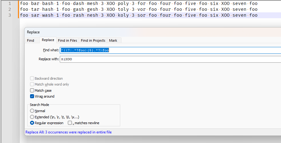

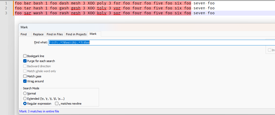

        • FraF Offline
          Fra @PeterJones
          @PeterJones Nice solution, with minimal editing needed, just what I was looking for!
          Thanks for the refs too, I’ll check them out asap!
          Nice too the indexing starts from zero:
          {0} = 1st occurrence.
          ^((?:.*?foo){0}.*?)foo
          Output:
          XOO bar bash 1 foo dash mesh 3 foo poly 3 for foo poly 3 for foo poly 3 for foo
          {1} = 2nd occurrence.
          ^((?:.*?foo){1}.*?)foo
          Output:
          foo bar bash 1 XOO dash mesh 3 foo poly 3 for foo poly 3 for foo poly 3 for foo
          {2} = 3rd occurrence.
          ^((?:.*?foo){2}.*?)foo
          Output:
          foo bar bash 1 foo dash mesh 3 XOO poly 3 for foo poly 3 for foo poly 3 for foo
          {3} = 4th occurrence.
          ^((?:.*?foo){3}.*?)foo
          Output:
          foo bar bash 1 foo dash mesh 3 foo poly 3 for XOO poly 3 for foo poly 3 for foo
          {4} = 5th occurrence.
          ^((?:.*?foo){4}.*?)foo
          Output:
          foo bar bash 1 foo dash mesh 3 foo poly 3 for foo poly 3 for XOO poly 3 for foo
          {5} = 6th occurrence.
          ^((?:.*?foo){5}.*?)foo
          Output:
          foo bar bash 1 foo dash mesh 3 foo poly 3 for foo poly 3 for foo poly 3 for XOO
          and so on.

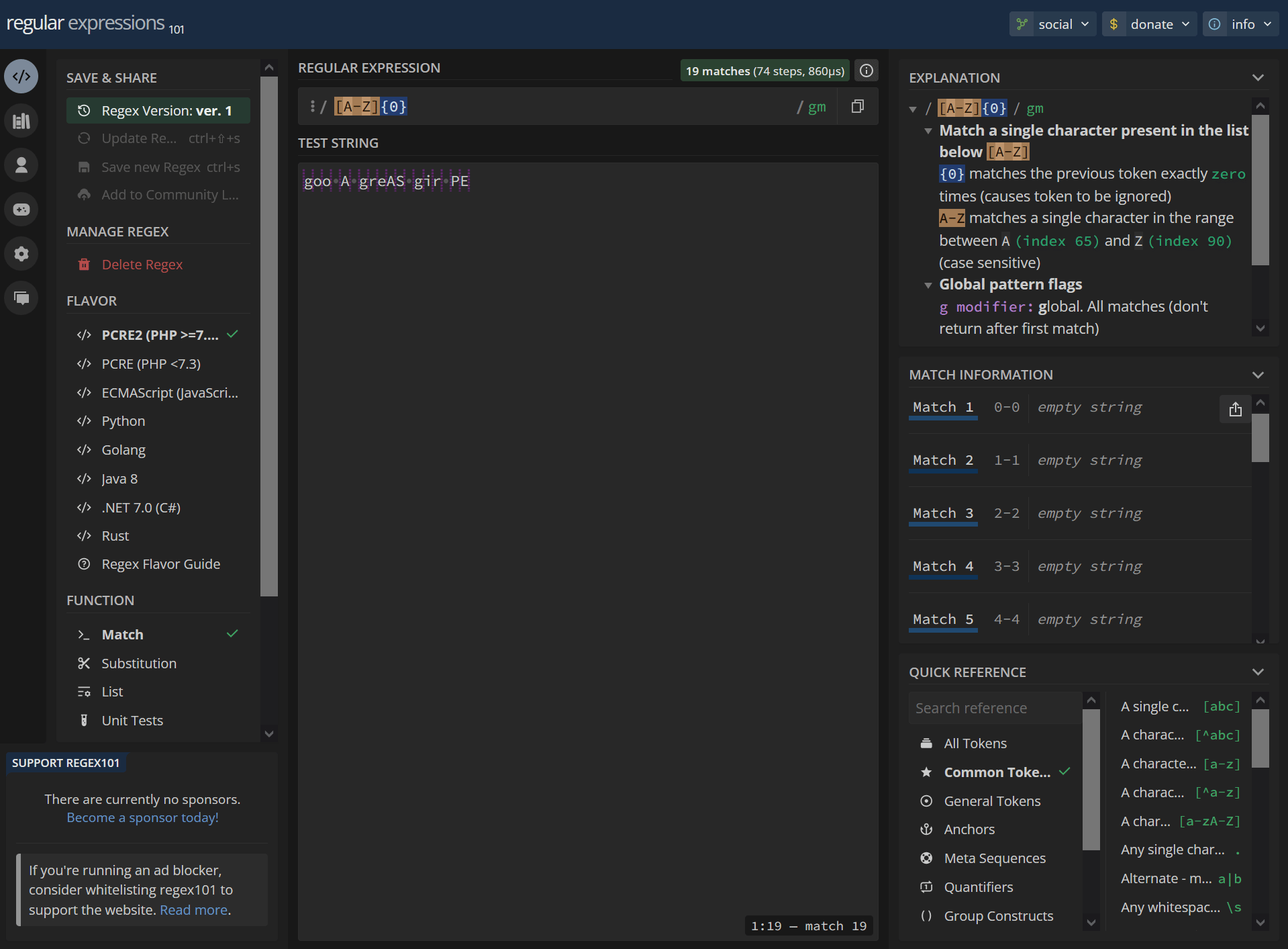

              For example:
              19 empty string matches:
              [A-Z]{0}
              goo A greAS gir PE
              https://regex101.com/r/dYnJmE/1
              [A-Z]{0}
              gm
              Match a single character present in the list below [A-Z]
              {0} matches the previous token exactly zero times (causes token to be ignored)
              A-Z matches a single character in the range between A (index 65) and Z (index 90) (case sensitive)
              Global pattern flags
              g modifier: global. All matches (don't return after first match)
              m modifier: multi line. Causes ^ and $ to match the begin/end of each line (not only begin/end of string)
              0-0	empty string
              1-1	empty string
              2-2	empty string
              3-3	empty string
              4-4	empty string
              5-5	empty string
              6-6	empty string
              7-7	empty string
              8-8	empty string
              9-9	empty string
              10-10	empty string
              11-11	empty string
              12-12	empty string
              13-13	empty string
              14-14	empty string
              15-15	empty string
              16-16	empty string
              17-17	empty string
              18-18	empty string

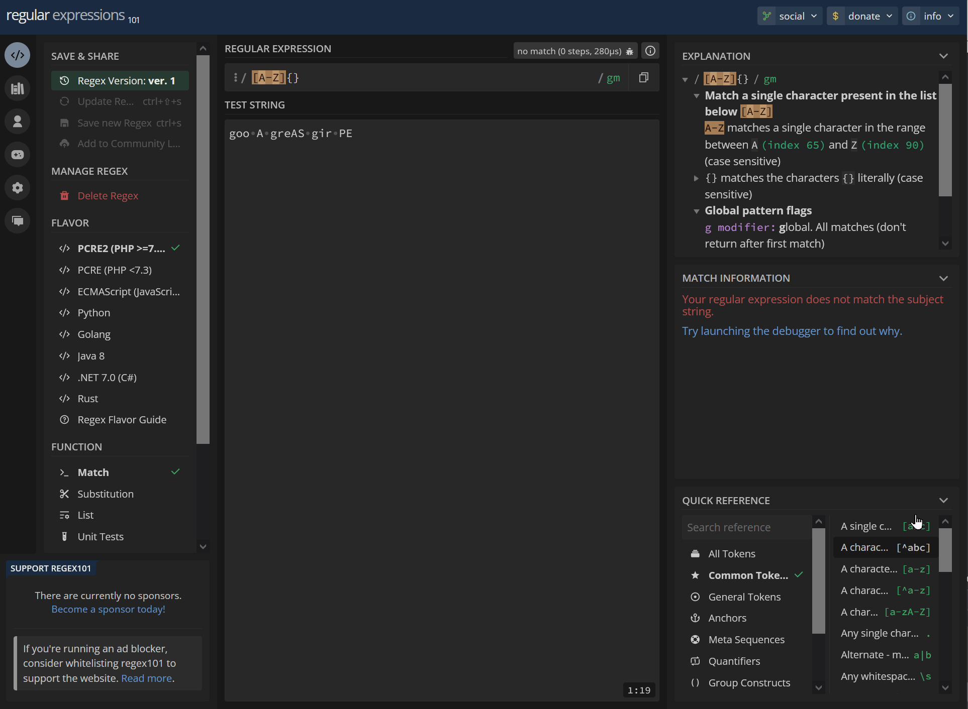

              No match/invalid:
              [A-Z]{}
              goo A greAS gir PE
              https://regex101.com/r/CtqQ0D/1
              [A-Z]{}
              gm
               matches the characters {} literally (case sensitive)
              Your regular expression does not match the subject string.

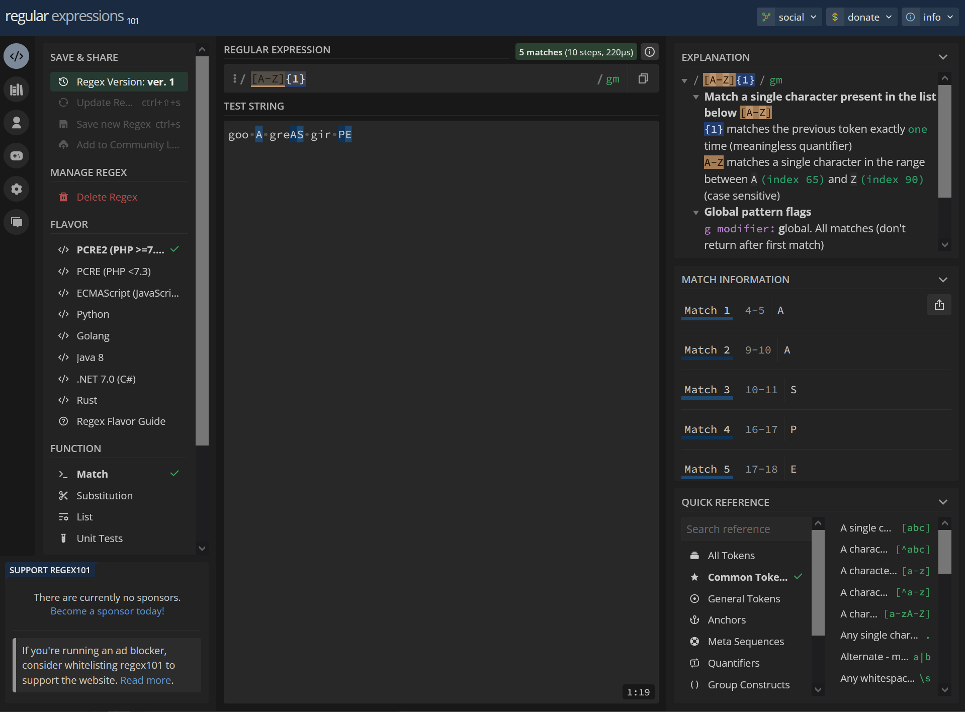

              5 matches:
              [A-Z]{1}
              goo A greAS gir PE
              https://regex101.com/r/MImsNL/1
              [A-Z]{1}
              gm
              {1} matches the previous token exactly one time (meaningless quantifier)
              4-5	A
              9-10	A
              10-11	S
              16-17	P
              17-18	E

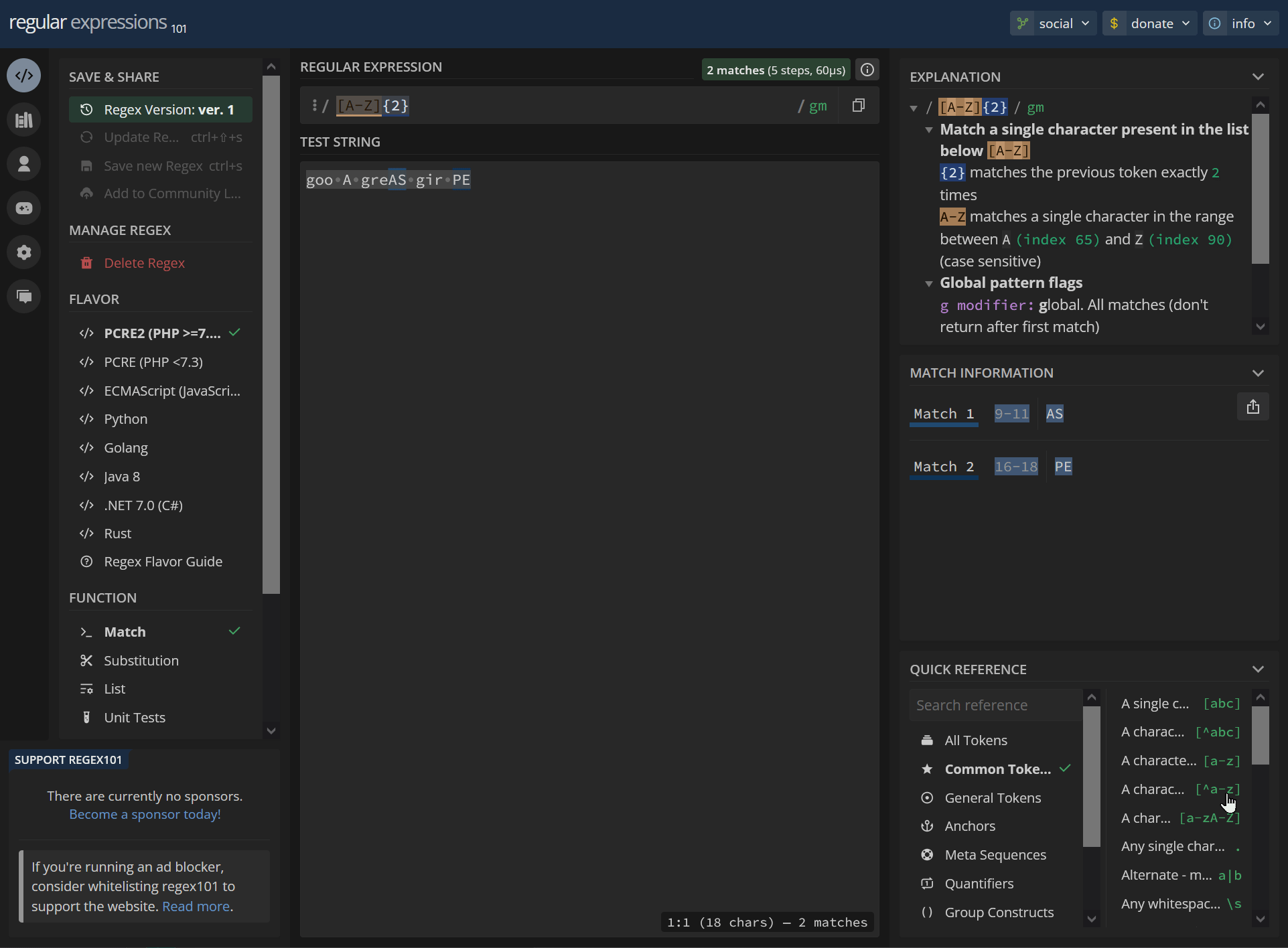

              2 matches:
              [A-Z]{2}
              goo A greAS gir PE
              https://regex101.com/r/p1WOWQ/1
              [A-Z]{2}
              gm
              {2} matches the previous token exactly 2 times
              9-11	AS
              16-18	PE
