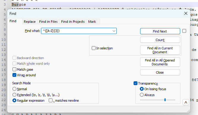

      I need to find only lines that begin with three capital letters, so I used the following:
      ^[A-Z]{3}
      For some reason, NP++ also finds the line that starts with “Bur”. Why is that?
      I know I can check the “Match Case” option but I shouldn’t have to.
      Thank you.

        @Shohreh said in [regex] Why unexpected hit?:
        Yes you should. That checkmark literally tells the regular expression engine whether to do case sensitive or case-insensitive matching. With “match case” off, then U in the regex matches U or u in the text, whether it’s in the regular expression as a literal U or whether it’s in a range like [A-Z].
        If you don’t like clicking a checkbox, you could instead use the regular expression command that forces case sensitivity, specifically (?-i) (“turn off case-insensitive matching”), so your regex could be (?-i)^[A-Z]{3} to force case-sensitive matching.
        But you absolutely, positively must set case sensitivity on via one of those two methods if you want any U in the regex to only match uppercase U and not lowercase u – that’s literally what “case sensitive”/“match case” vs “case insensitive”/“don’t match case” means.
