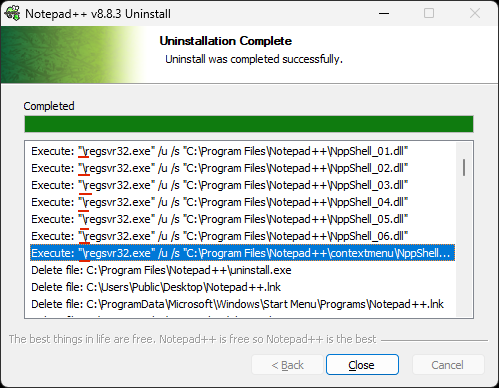

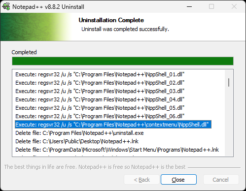

            @mpheath said in Installation Bug?:
            uninstaller appears to be bugged regarding the unregistering of the context menu extension
            I can confirm:
            • v8.8.2 ok (but vulnerable to the reported regsvr32/rundll32 hijacking CVE):
            • v8.8.3 regression:
            If you can, please create a GitHub regression issue for it and link there the culprit.

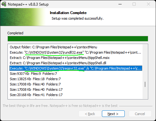

            OTOH, the v8.8.3 installer is ok (and not sensitive to that hijacking by using fullpaths):
            mpheathM 1 Reply Last reply Reply Quote 2
