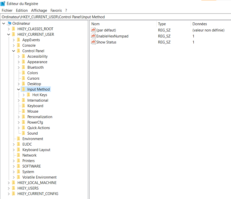

            Secondly, as within your laptop, I have the EnableHexNumpad value set to 1 :
