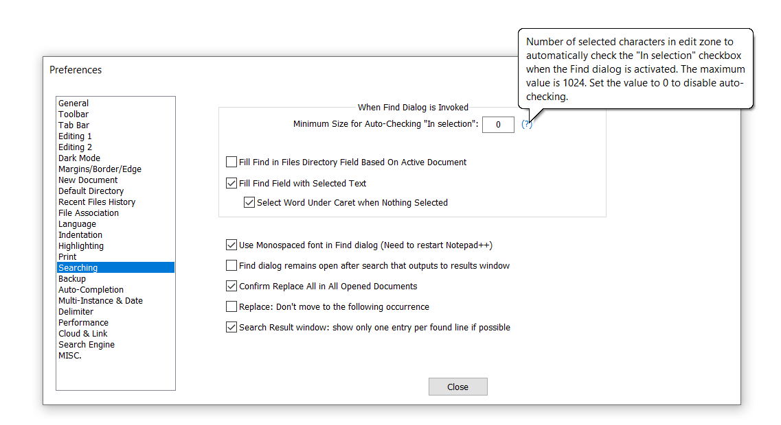

      I’m very certain that I’ve attempted, unsuccessfully, to paste multi-line text into FIND/REPLACE/MARK etc. string input zones many times, going back 10 years or more, though I always assumed that any line ending sequence was disallowed (I pretty much always use CRLF, myself). Of course, at least with the appropriate setting (I forget specifically, but think offhand that there is a setting for it), if you have text selected before you open the FIND/REPLACE/MARK dialog, that text then populates the FIND WHAT field, line endings and all. I just wish I could see them when they’re in there.
        Hi, All,
        Holidays are over and I’m back home. So, let’s resume our discussion. I’m quite sure there are a lot of problems with the new Search and Replace dialog, in the v8.8.4 relaease, because of the new feature :
         4. Increase search input length from 2046 to 16383.
        I assume that :
        • The Maximum Size for Auto-Checking "In selection", in Settings > Preferences... > Searching, is set to 0
        • The Search mode of the Find dialog is set to Normal
        • All other options of the Find dialog are unckecked
        If I chose these preferences about searching :
        And if I consider the text below :
        1234567890123456789012345678901234567890123456789012345678901234567890123456789012345678901234567890123456789012345678901234567890123456789012345678901234567890123456789012345678901234567890123456789012345678901234567890123456789012345678901234567890123456789012345678901234567890123456789012345678901234567890123456789012345678901234567890123456789012345678901234567890123456789012345678901234567890123456789012345678901234567890123456789012345678901234567890123456789012345678901234567890123456789012345678901234567890123456789012345678901234567890123456789012345678901234567890123456789012345678901234567890123456789012345678901234567890123456789012345678901234567890123456789012345678901234567890123456789012345678901234567890123456789012345678901234567890123456789012345678901234567890123456789012345678901234567890123456789012345678901234567890123456789012345678901234567890123456789012345678901234567890123456789012345678901234567890123456789012345678901234567890123456789012345678901234567890123456789012345678901234567890
        • Select the first 1,024 digits, above, leaving the remainder 567890
        • Open the Find dialog ( Ctrl + F )
        => You correctly see the first 1,024 characters of this single line are filled in the Find field and can be matched again !
        • Close the Find dialog ( Esc )
        • Select the first 1,025 digits, above, leaving the remainder 67890
        • Hit the Delete key to suppress any text in the Find field ( IMPORTANT )
        • Re-open the Find dialog ( Ctrl + F )
        => The Find field is totally empty ?!
        I would have expected that the first 1,025 characters would have been filled in the Find field, because of my preference :
        Fill Find Field with Selected Text , which is checked
        And this should be true from 1,025 to 16,383 digits, which is the new limit !
        Can anyone confirm this simple test ?
        Note that I found out other oddities, that I will develop later. Everything in its own time !
          Alan Kilborn @guy038
          Yes.
            The problem when selecting 1025+ characters as a pre-step is because of this line of code:
            https://github.com/notepad-plus-plus/notepad-plus-plus/blob/dab30de9c677165fcd7f9cc045b4529ab0c4f7b7/PowerEditor/src/NppCommands.cpp#L1380
            FINDREPLACE_INSELECTION_THRESHOLD_DEFAULT is set to 1024, here:
            https://github.com/notepad-plus-plus/notepad-plus-plus/blob/dab30de9c677165fcd7f9cc045b4529ab0c4f7b7/PowerEditor/src/Parameters.h#L167
            Probably the check against that constant should not be made if Maximum Size for Auto-Checking "In selection", in Settings > Preferences… > Searching, is set to 0.
