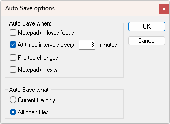

        If I set the options to:
        … I then have to exit Notepad++ normally (File > Exit or the upper-right X), then it writes the updates to %AppData%\Notepad++\Plugins\Config\AutoSave.ini – it doesn’t write the config file when I say OK, it waits until I exit Notepad++. So look at the AutoSave.ini last-changed date while Notepad++ is open. Then change AutoSave>Options…, click OK, then exit Notepad++; refresh the Explorer window and see if the AutoSave.ini date changes to the most recent timestamp. If not, then the settings for AutoSave aren’t where you think you are (and that strengthens the idea that you have multiple copies of Notepad++ floating around).
