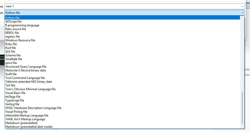

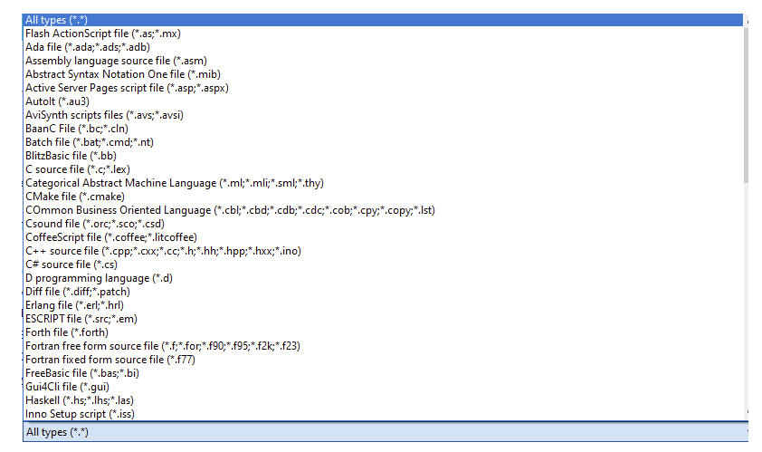

      I had to reinstall Notepad++ on a new windows build and when I did, these file type extensions disappeared when I click Save As and I cannot seem to get them to re-appear.
      Any suggestions?
        PeterJones @joesalvati68
        @joesalvati68 ,
        What do you mean by “disappeared”? Your screenshot shows it working, so it’s hard to know what exact problem you have.
        • Do you mean that you ran it, and the popup showed, and then collapsed? All you should have to do is hit the pulldown ﹀ to get it to show again.
        • Do you mean that you hit the ﹀ and it no longer shows? If so, does nothing happen, or does it show an empty list?
        • Do you meant that it has a list, but it’s white-on-white text (or some such combination)?
        When you installed Notepad++ on the new Windows build, did it properly create %AppData%\Notepad++ (assuming a normal installation) and the files inside (including %AppData%\Notepad++\langs.xml)? Because Notepad++ gets the list of SaveAs types and extensions from that langs.xml. You might want to share your ?-menu’s Debug Info to help us understand more about your installation, so we can be more specific in our advice.
        If langs.xml exists but is empty, then that pulldown might be empty. But if you exit Notepad++, delete it, and re-run Notepad++, it should re-create langs.xml from the install-directory’s langs.model.xml (Of course, if langs.model.xml is missing or corrupt, that might explain the problem with langs.xml)
        But, in general, my response is “it works for me”, so we’ll need more from you to be able to figure out what’s wrong.
        J 1 Reply Last reply Reply Quote 0

          @PeterJones I tried replying but not sure if it went through. I copied the above picture. My actual wndow is here.
          and this is my debug info

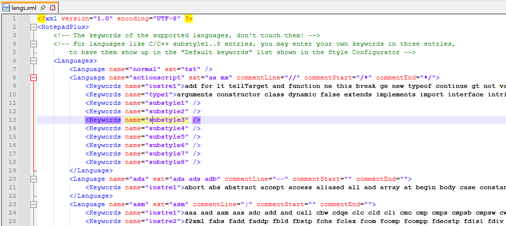

            If disbling that plugin doesn’t fix it, then open C:\Users\JoeSalvati\OneDrive - Arcuity ai, Inc\Notepad++_backup\langs.xml, and show us the first 25 lines or so, using a screenshot like:
            or click the </> button in your reply, and pasting the text of the first 25 lines inside the ``` … ``` section:
