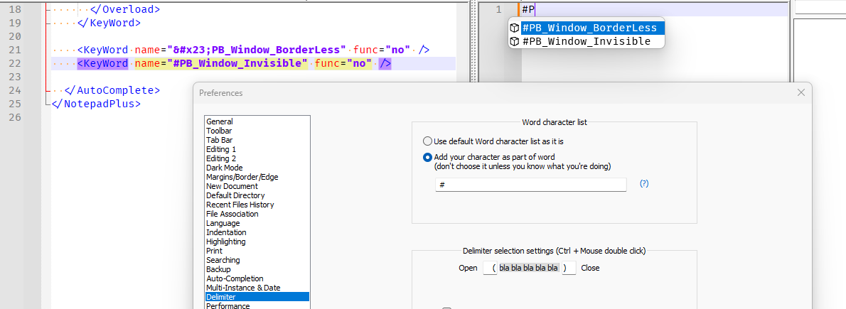

        @spikey-pb said in AutoComplete XML Problem:
        Does anyone have any suggestions?
        When Notepad++ is doing auto-completion, it goes back to the first “word character” (A-Z, 0-9, _, and various unicode letters or numbers, and anything you define in the Delimiters settings), so it doesn’t include punctuation with default settings.
        Thus, it does not see the # at the beginning as being part of a “word” when trying to auto-complete #PB_Window_Invisible, so it doesn’t match.
        Secondly, the XML library that is used for processing the config files doesn’t seem to handle the decimal &# sequences under all circumstances; instead, use &#x0023; or the shorter &#x23; to represent the # – but even with that, Notepad++ will not auto-complete from there out-of-the-box.

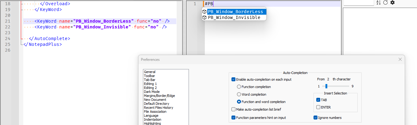

        You have two choices:
        1. Don’t include the # in the keyword name. If you just have PB_Window_BorderLess and PB_Window_Invisible, then typing #P will still allow you to auto-complete on those, but it won’t start your character count until the P instead of the #. So if you have your auto-complete threshold at 2, you’d have to do #PB instead of #P before it would pop up
          • but this has the drawback that if you type PB_ even without the # prefix, it will still suggest those words in auto-completion, which may or may not be acceptible to you.
        2. Use Settings > Preferences > Delimiter’s Add your character as part of a word field to include # as a pseudo “word” character.
          • See Settings > Preferences > Delimiter in the User Manual

          You’d have to do #PB instead of #P before it would pop up
          By default the PureBasic IDE doesn’t show autocomplete before 3 characters anyway so I can’t see an issue there personally, but there’s a workaround for anyone who just can’t live with that.
