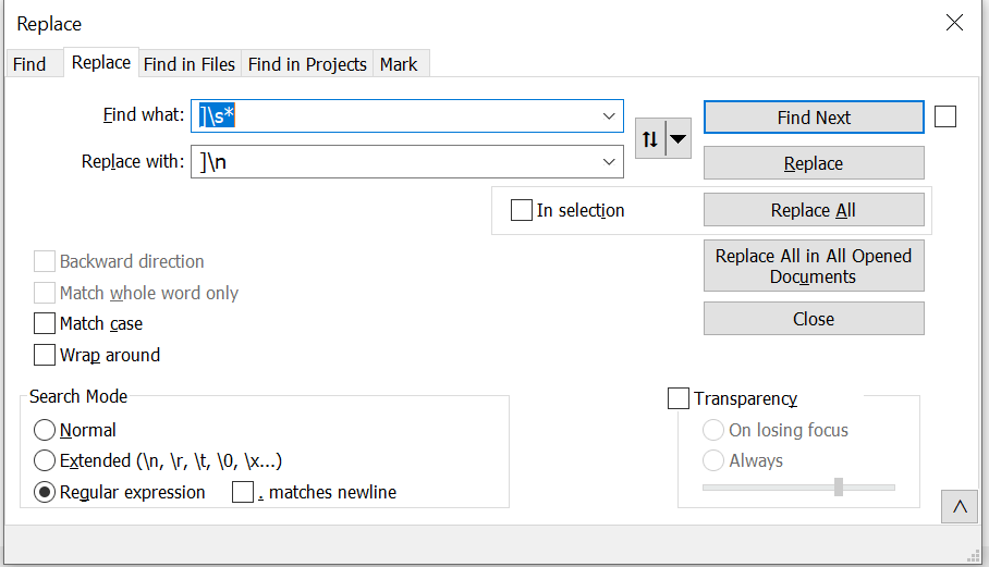

      I’ve tried adding new lines by using the replace function by adding new lines after the brackets and curly brackets but that only increased the total amount of lines to around 90,000.

        PeterJones @Joep Kregting
        @Joep-Kregting ,
        With just Notepad++, there isn’t a great way. If you are willing to install a plugin, then I would recommend @Mark-Olson’s JsonTools plugin (to install the plugin, use Plugins > Plugin Admin, checkmark JSON Tools, and click Install).
        Once it’s installed, you can open your mod’s data file (the one that’s flat), and then use Plugins > JsonTools > Pretty-print current JSON file to make it more like the original.
        (I cannot guarantee that the plugin’s pretty-print routine will exactly follow the same rules as the original game file. But if you want to look at them both with the same formatting rules, you can use Pretty-print on the original file, as well, which will make them both have the same consistent formatting.)
