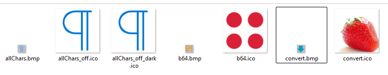

        Using the following as the icons in my ...\plugins\Config directory (for the CustomizeToolbar plugin):
        And this as my new.ico for use in my ...\toolbarIcons\myAwesomeIcons folder:

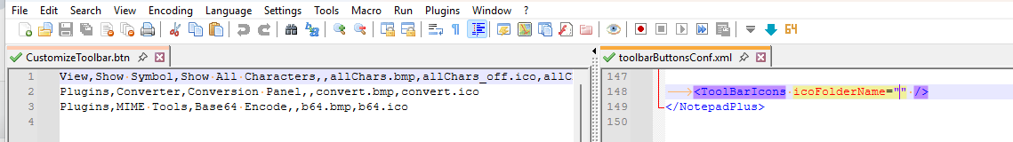

        When I don’t have toolbarIcons enabled, I see:
        … Based on the images, Notepad++ is using the standard icons: small for the toolbar, and CustomizeToolbar thus picks the BMP versions (down arrow for convert.bmp and 64 for b64.bmp)

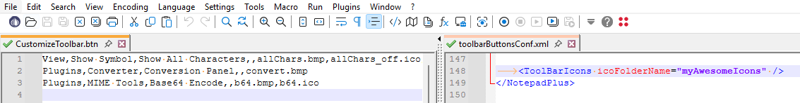

        When I enable toolbarIcons, I see
        … The single red strawberry is convert.ico, and the four red dots are b64.ico… And you’ll also notice that Notepad++ switches to the Fluent UI: small icons (even though my settings still say standard icons: small – because with toolbarIcons enabled, Notepad++ always uses one of the Fluent sets as the starting point)

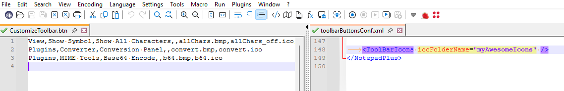

        If I remove the ,convert.ico from the CustomizeToolbar.btn and restart,
        View,Show Symbol,Show All Characters,,allChars.bmp,allChars_off.ico,allChars_off_dark.ico
        Plugins,MIME Tools,Base64 Encode,,b64.bmp,b64.ico
        … I can replicate your problem, and the Conversion Panel button shows up as the ? error:
        To fix your problem, you need to create and reference an appropriate .ico file for all your custom buttons

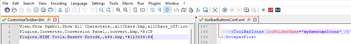

        If you ever don’t want to create the button, you can use the Customize Toolbar “Quick Codes” (which are described in Plugins > Customize Toolbar > Help - Custom Buttons or the comments in the default CustomizeToolbar.btn file. For example, here is a version with using a red CP for Conversion Panel, and a grayish 64 for the Base64 Encode:
        Plugins,Converter,Conversion Panel,,convert.bmp,*R:CP
        Plugins,MIME Tools,Base64 Encode,,b64.bmp,*#123456:64
        So, you either need to set a .ico or a Quick Code in the field after the bmp, and it should work for you.
