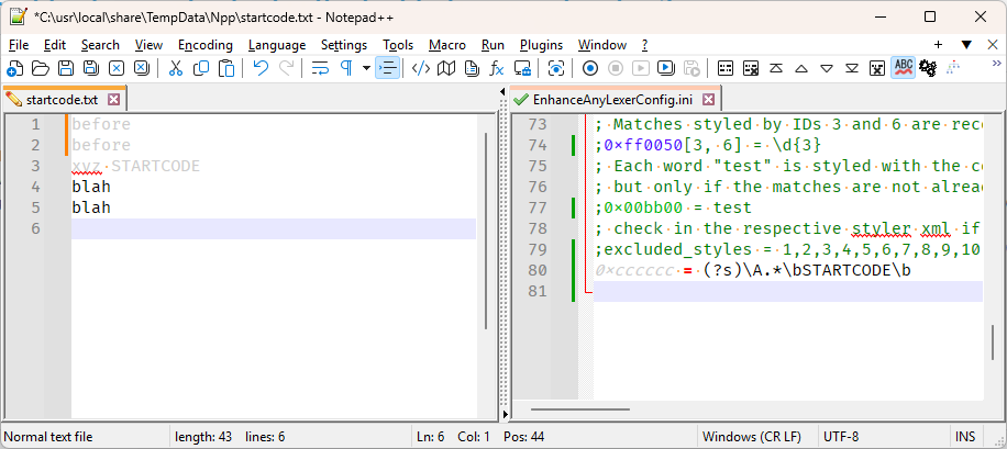

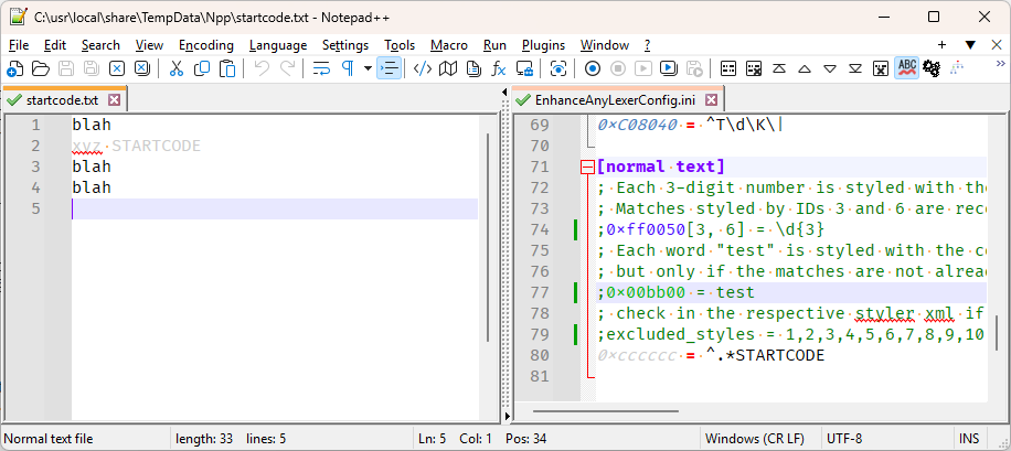

        (My screenshot shows it in the [normal text] section, since I didn’t want to create a new UDL for this example, but if you’ve got a UDL called exact name of UDL, then the second section in my post would do it.)

        were you intending the gray text to just be the xyz STARTCODE, or did you want to also gray out the before lines?
        If the latter, then your EnhanceAnyLexer line would be more like,
        0xcccccc = (?s)\A.*\bSTARTCODE\b

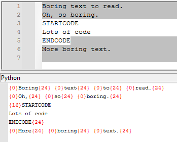

                      May need to restart Notepad++ after setup of the UDL and the Lua code. Once the editor is ready and the document is active, then set the language to the UDL.
                      Viewed with the default theme:
                      The Python console shows the Style IDs in red so you know where the 0, 16 and 24 originate from.
                      Other scripting plugins should be able to apply styles with similar code.
