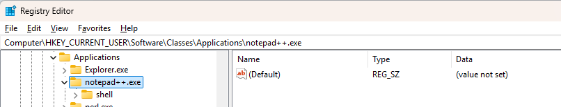

                  Earlier, I mentioned HKCU\Software\Microsoft\Windows\CurrentVersion\Explorer\FileExts\ . Since my brief description of what was needed was based on my Win11 experiments a year or two ago, and I’m on a fresh computer compared to those, I thought I’d experiment just to make sure, and it does in fact work.
                  Below, when I mention “key”, it will be displayed as a “folder” in the Registry Editor treeview on the left.
                  • After installing Notepad++, and/or using MS Window’s “Open With” dialog to select Notepad++ as the default application for .txt files, my Windows Explorer shows Notepad++'s icon for .txt files:
                  • Run regedit.exe and paste in that key name HKCU\Software\Microsoft\Windows\CurrentVersion\Explorer\FileExts\ into the “address bar” of the regedit window:
                    • I navigated to the UserChoice key to show that Applications\notepad++.exe is chosen, showing that Notepad++ is my default app for .txt files
                  • Go to HKCU\Software\Classes\Applications\ , and you should see notepad++.exe as one of the keys
                    • Right Click on notepad++.exe and choose to create a New > Key called DefaultIcon (no space)
                    • On the (Default) in the right panel, insert the path to the ICO file: 809d369f-f720-44df-b44b-d90cdc2dd48e-image.png
                      • This was just an example icon that I knew where it was on my PC.
                      • You could also use something like the MS Windows notepad.exe’s icon, using %SystemRoot%\System32\notepad.exe as the (Default) value there
                      • or %SystemRoot%\System32\imageres.dll,-102 will use icon #102 from imageres.dll, which for my version of imageres.dll is another “text file” icon.
                      • you just need to pick an icon you like, and point the registry entry there
                    • If you close all Windows Explorer windows and re-open, .txt files will probably show up with the new icon.
                      • Some users find that exiting Explorer isn’t sufficient. If that’s true for you, try one or both of
                        • log out and back in
                        • reboot
                      • Advanced users will be able to use nircmd shellrefresh or otherwise send SHChangeNotify( SHCNE_ASSOCCHANGED , SHCNF_IDLIST , NULL , NULL ); , and be able to avoid even closing the Explorer window(s) – but if you don’t understand either of what I said, then this option isn’t meant for you.

                  N 2 Replies Last reply Reply Quote 3

                          NolanNolan @PeterJones
                          i have to hand it to you this worked, thank you :-)
                          I couldnt find this description elsewhere, i tested all the 3 thirdparty apps, wthy didnt work though
                          I seems to have missed the reg addition of defaulticon should be in the string sith notepad++
