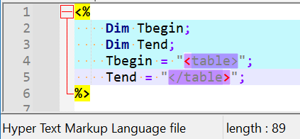

                  My initial response to N++ issue #17072 was to assume it was a duplicate of another issue caused by the tag highlighting feature, which will naïvely find “tags” in contexts where there is no HTML markup; e.g.,
                  This only occurs when the active language is HTML and the Enable option is checked under Settings > Preferences > Highlighting > Highlight matching tags .

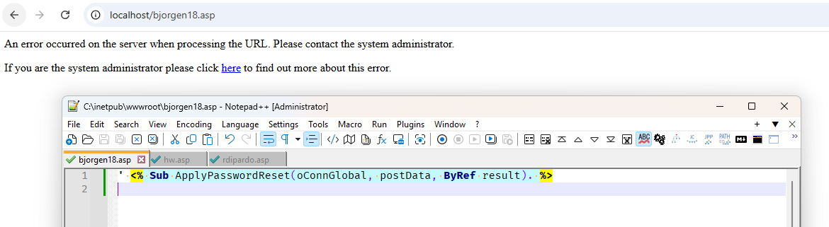

                        Sadly, you did not give nearly enough for us to be able to investigate your problem any further. I put in exactly that line (and only that line) into bjorgen.asp on my local IIS, and when I go to that page, it gives me a server error:
                        … And I confirmed that other pages, like the one I showed above, are still working on my local server.
                        From what I understand, the ' as a comment is VBSCRIPT syntax, not ASP-specific syntax. Because I thought everything outside of <% ... %> was just interpreted as ASP (and my quick web searches seem to confirm that conclusion on my part). In which case, putting the ' before a <% ... %> line is not “commenting out” anything, it’s just putting a single-quote in the static HTML portion of the code. Moreover, you aren’t supposed to nest <% ... %> inside each other, as far as my searches tell me. So your single line is really confusing… because if it’s outside of a containing <% ... %>, then I don’t see why you think that the ' is commenting anything. And if it’s inside a containing <% ... %>, I don’t see why you have another <% ... %> nested inside. This is why a complete example is needed for us to be able to see what you mean. It doesn’t have to be huge – my example document from earlier (with the . ' what goeth here in the rendering) is only about a dozen lines.

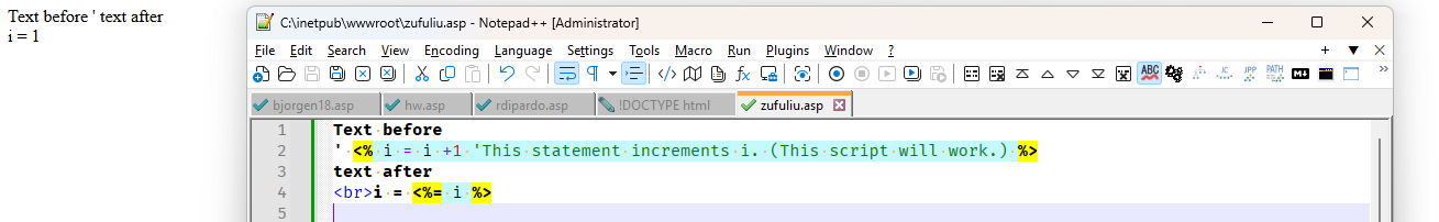

                        Taking that line, and putting it into zufuliu.asp with a few other lines,
                        Text before
                        <% i = i +1 'This statement increments i. (This script will work.) %>
                        text after
                        <br>i = <%= i %>
                        … to actually render something in the webpage, I see:
                        And Notepad++ is highlighting that as expected: the i = i + 1 is code, the 'This statement increments i. (This script will work.) is a comment, and the %> still closes the code, and everything after still runs.
                        Moreover, if I use a ' to “comment out” the <% ... %> line, it doesn’t actually make that code not run. It just interprets the ' as part of the HTML, not as part of the VBSCRIPT.
                        So your single line of ' <% Sub ApplyPasswordReset(oConnGlobal, postData, ByRef result). %> does nothing to show us where the bug might be, or what’s going wrong.
                        To be able to prove whether there’s a bug in Lexilla, a bug in Notepad++, or just user error, you need to give a complete known-good ASP code that shows the problem, that we can open with IIS to see that the code works as expected (ie, to show it’s valid ASP that you are trying to edit), that we can open with Notepad++ to see that it highlights “wrong”, and opens with SciTE to show that it highlights “right” or “wrong” depending on what you say (the last time, I believe I understood you to say that it was rendering right in SciTE),
                        If you want help, you need to give all the information from the 3 simple steps I put in my last post and reiterated here. Please understand, I am not saying this to be mean: the Lexilla people do not believe there is a bug in their library (the issue has been closed as PEBKAC). Nothing you have shown us gives evidence of a bug in Notepad++. If you don’t provide exactly what I described above, your report will be diagnosed to be user error, and nothing will ever happen.
