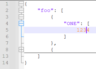

      For example, suppose I have this document:
          "foo": [
                  "ONE": [
                      1234
                  "TWO": [
                      null
      and suppose that my caret is currently at position 70 inside the number 1234, four fold levels deep.
      Now suppose that use View->Fold Level->3 to fold the document so it looks like this:
      Now my caret is hidden, and I want to unfold just enough to make the caret visible, so that the document would look like this:
      Since the caret is currently under fold level 4 but the uppermost fold level above it is level 2, View->Unfold Current Level doesn’t do what I want. The folding command that would come closest to achieving my goal would be View->Unfold Level->3`, but (a) that would unfold everything at that fold level (not just directly above the caret), and (b) I would need to know to unfold level 3, as opposed to some other level.
