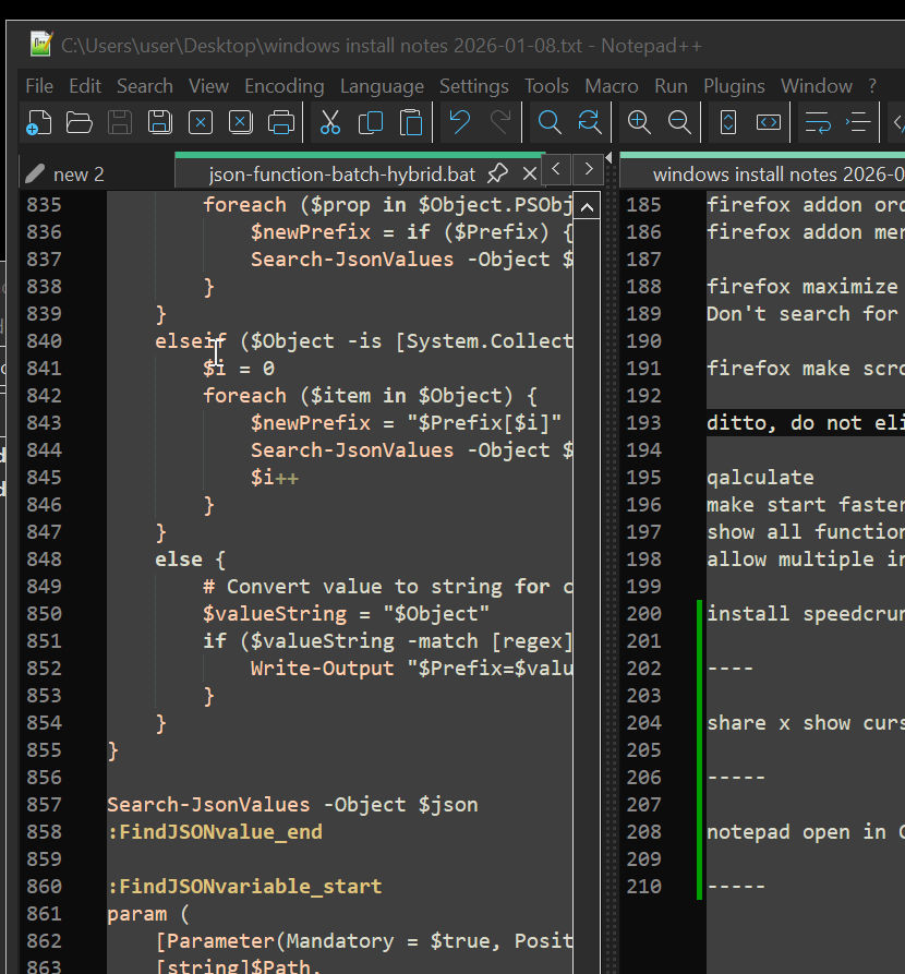

      I wanted to move the “other view” separator with more ease
      That bar in the middle
      And I tried middle-click-drag, and it does nothing, there is no action associated with that button
      I was wondering if I could make a plugin that
      When I middle-click-drag left and right, it would move the separator left and right ?

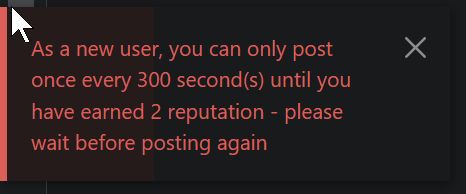

      ok I’ll wait

        Left click and drag isn’t easy enough for you?
        Alan KilbornA S 2 Replies Last reply Reply Quote 0

          I think maybe what was meant was “middle click anywhere in either window” to initiate the desired behavior?

              Yes by that I mean at positionning the cursor on a 15 pixel wide bar and then left-click-dragging it left and right, is more difficult than.
              Placing the cursor anywhere on the window and middle-click-dragging left and right.
