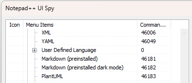

        And this is not a bug. The notepad.runMenuCommand() interface is well established as being based on the name of the menu item. It literally searches the underlying win32 menu objects looking for matching text. If you want a new command that runs it based on menuCommand-ID, you could request that (if it didn’t already exist). But note, that’s precisely what notepad.menuCommand() does – it “Runs a Notepad++ menu command. Use the MENUCOMMAND enum, or integers directly from the nativeLang.xml file.” So if you want to use Command ID, then use notepad.menuCommand(). If you want to use the name of the command, use notepad.runMenuCommand().
