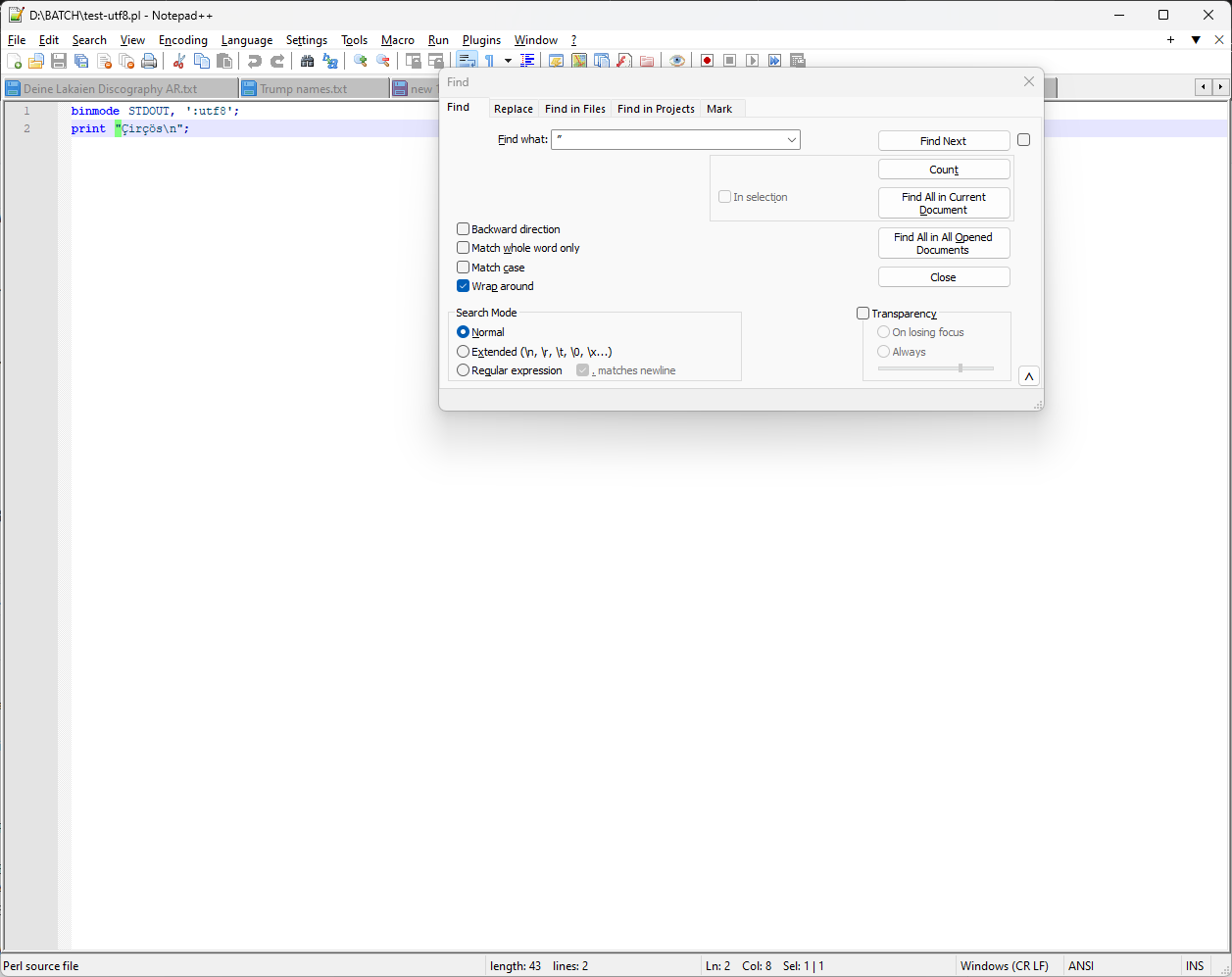

      This match was found by a file search. I didn't expect that the ″ character would be found in this file.
      To accomplish this, I have tried using the following Find/Replace expressions and settings
      • Find What = ″
      • Replace With =
      • Search Mode = NORMAL
      • Dot Matches Newline = CHECKED
      Unfortunately, this did not produce the output I desired, and I’m not sure why. Could you please help me understand what went wrong and help me find the solution?

        I’m not convinced that is the problem, though. In the screen shot you included, the quotes look like straight quotes, not typographic quotes. You’ve highlighted the quote mark, but that appears to be just your selection, not the result of a search; I think the search you show in that screen shot will not (and should not) match.

          @Coises: I didn’t think that there is a non-ASCII end quote in the file. Notepad++ finds both straight quotes with a search for a typographic end quote. (The fact that I was doing a file search turned out to be irrelevant; the behavior can be replicated with a simple search of the file.)
          The current ANSI codepage is 1252.
          If I reopen the file then select Windows-1254, the characters appear unchanged, but then the search does not find the typographic end quote, which was the behavior that I expected.

          I can reproduce the file contents and the unexpected behavior by pasting the characters into a new file (which Notepad++ identifies as UTF-8), saving it, selecting “ANSI” and saving it again.
          UPDATE: I haven’t been able to successfully create a Windows-1252 file containing a typographic (“smart”) end quote with Notepad++, but I can do so with a hex editor. Notably, this character does not have quite the same visual appearance in Notepad++ as the UTF-8 “smart” end quote.

            I was able to do that, too… and now I see what is happening. The character you are calling an end quote is not the Right Double Quotation Mark, U+201D but the Double Prime, U+2033.
            Windows-1252 (and Windows-1254) contains the right double quotation mark at 0x94. However, it does not contain the double prime. The entry boxes on the file dialog are always in Unicode. (That’s how it works pretty much everywhere in modern Windows.) But if the file is in ANSI, the file search is done in ANSI, so Notepad++ asks Windows to translate the string you gave it into ANSI. Seeing that there is no double prime character in your current code page, Windows “helpfully” translates it to something that looks a lot like it… the ASCII double quote.
            Further confusing the issue is that Notepad++ never loads a file in any code page other than your system code page (which you said is 1252) or Unicode. So when you open the file in Windows-1254, Notepad++ is actually converting it from 1254 to UTF-8 and editing that way. That’s why the search behaved as expected in 1254: it wasn’t really 1254 in, it was in UTF-8.
            Bottom line… this behavior actually is “expected”… but not by any normal human being. About the only thing you can do about it is to work in Unicode wherever possible when you are using non-ASCII characters.
            It might be possible for Notepad++ to change its search so that it warned you when you tried to search an ANSI document for characters that aren’t possible in that document. I haven’t looked into it in depth; I would guess there must be a call to WideCharToMultiByte somewhere, and it could be passed the WC_NO_BEST_FIT_CHARS flag and the lpUsedDefaultChar output pointer to detect such shenanigans so the program could tell the user about it instead of potentially claiming to find something that isn’t there.
