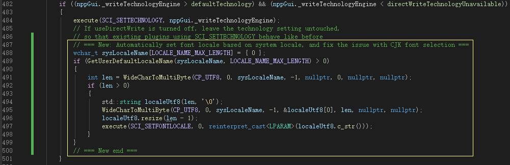

      The repair method is as follows:
      After enabling DirectWrite, the correct font locale will be automatically set according to the system locale in the init method:
      Taking the notepad-plus-plus-8.9.2 source code as an example, modify the if statement starting from ScintillaEditView.cpp:482 to the following:
      		// === New: Automatically set font locale based on system locale, and fix the issue with CJK font selection ===
      		wchar_t sysLocaleName[LOCALE_NAME_MAX_LENGTH] = { 0 };
      		if (GetUserDefaultLocaleName(sysLocaleName, LOCALE_NAME_MAX_LENGTH) > 0)
      			int len = WideCharToMultiByte(CP_UTF8, 0, sysLocaleName, -1, nullptr, 0, nullptr, nullptr);
      			if (len > 0)
      				std::string localeUtf8(len, '\0');
      				WideCharToMultiByte(CP_UTF8, 0, sysLocaleName, -1, &localeUtf8[0], len, nullptr, nullptr);
      				localeUtf8.resize(len - 1);
      				execute(SCI_SETFONTLOCALE, 0, reinterpret_cast<LPARAM>(localeUtf8.c_str()));
      		// === New end ===
      After DirectWrite initialization, this code reads the user’s system language (such as zh-CN) and notifies Scintilla to use the corresponding font variant through SCI_SETFONTLOCALE. This ensures that the Simplified Chinese system (zh-CN) correctly selects the Simplified Chinese font, while the Traditional Chinese system (zh-TW) selects the Traditional Chinese font.

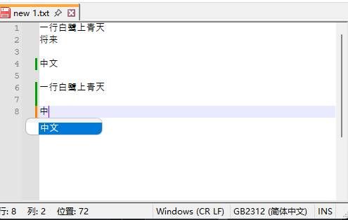

      Finally result:

          @rdipardo In Version 8.9.3, The program behaves correctly.
