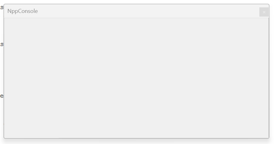

          I installed it successfully and tried it, but unfortunately I got some problems using it, essentially UI problems :
          • at launch, the console is displayed empty and grey, the content of the terminal is not displayed until i move the window to the side (for example).

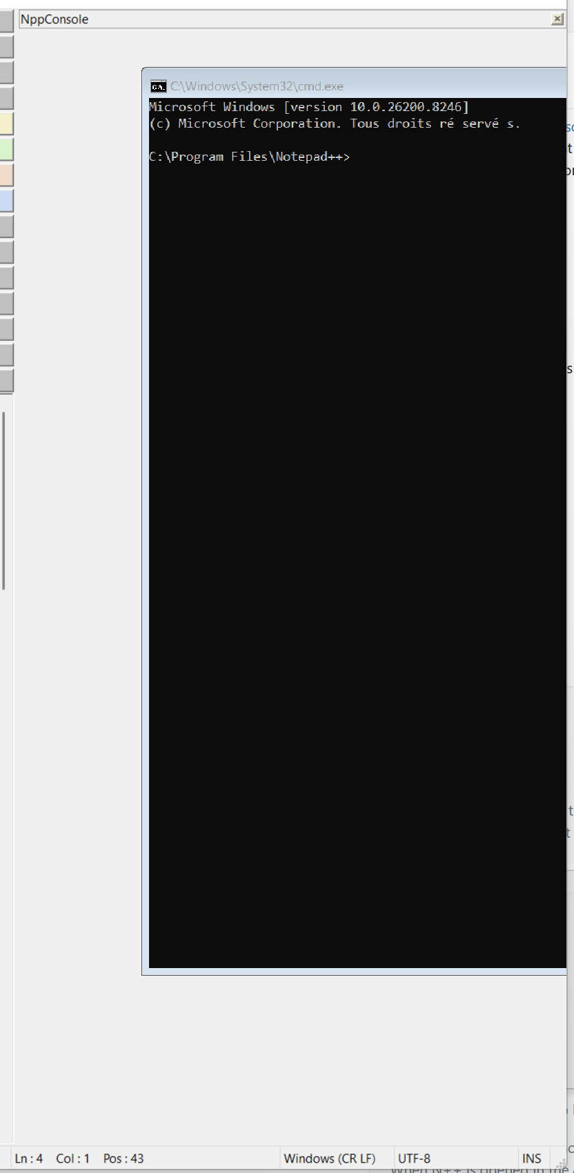

          • if i change the command in the about box to set it to powershell, i get straight the powershell windows at opening, but its size does not fit to the screen, so no line wrap. Changing the width of the NPP console window does not change anything.
          • Nevertheless, if i run powershell from cmd (in NppConsole), the width is OK.

                  I installed v1.2.8.1 (i can tell that it is the one running from the different menu options), but i have sometimes () similar issues :
                  grey console at launch.
                  ) it seems to be sensitive to history.
                  OK, i think i get it : It does not handle correctly 4K screen.
                  When N++ is opened in the 4K screen, i noticed that the terminal within the NppConsole does not occupy the full window -and cannot be resized to occupy the full window.
                  So i guess that when the Nppconsole is grey, the terminal within is out of bounds.
                  Restart console does not (always) help .

                    That does not surprise me. Notepad++ is still not great for high-DPI environments, and it’s been taking a long time to finish some of the last-remaining high-DPI issues. And if the main app, with lots of contributors, still has issues, then it should come as no surprise that the plugins, which usually only have one developer (if they remain interested), whose skillset usually focuses on the feature that their plugin implements, rather than on the generics of all the edge cases of modern win32 coding. (At least, I know that’s true for me on my plugin(s).)
                    I don’t have a High-DPI environment, so I don’t know and can’t test for you, but maybe the NppExec plugin handles high-DPI better than NppConsole does (whether the original, or the intermediate fork)
