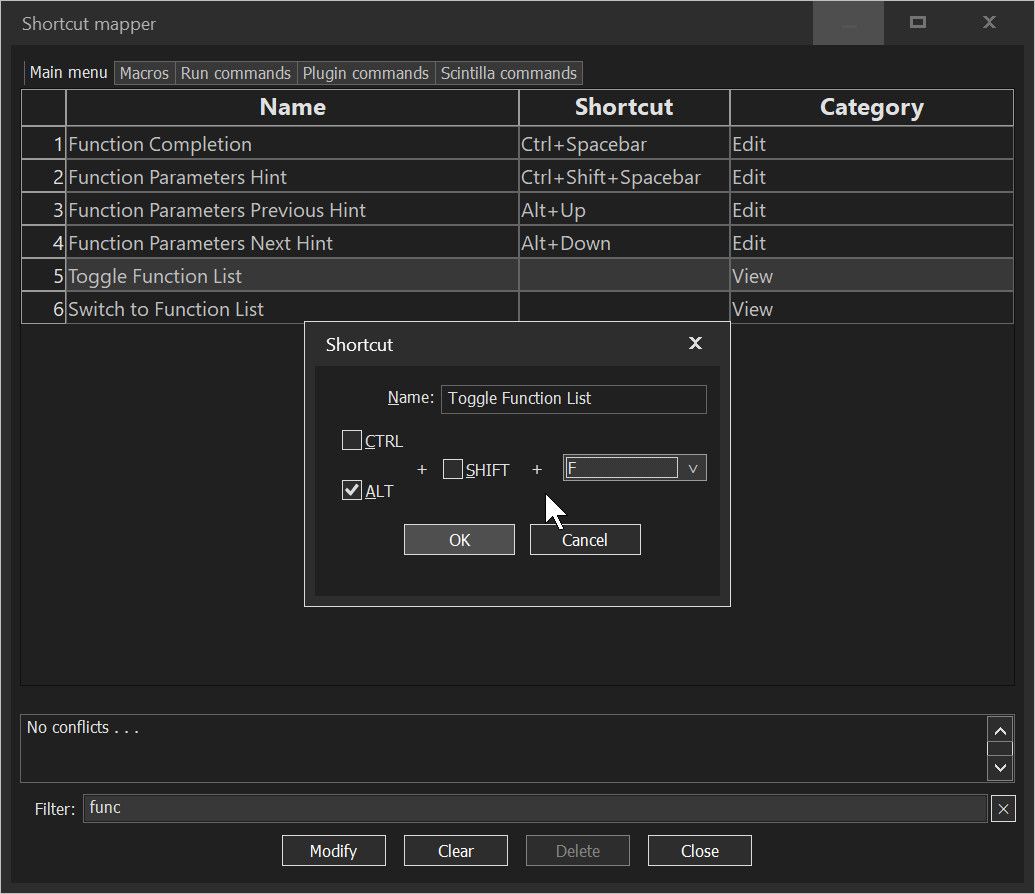

      1. I could not find the keybind, is there one ?
      I propose LeftALT+F by default ?

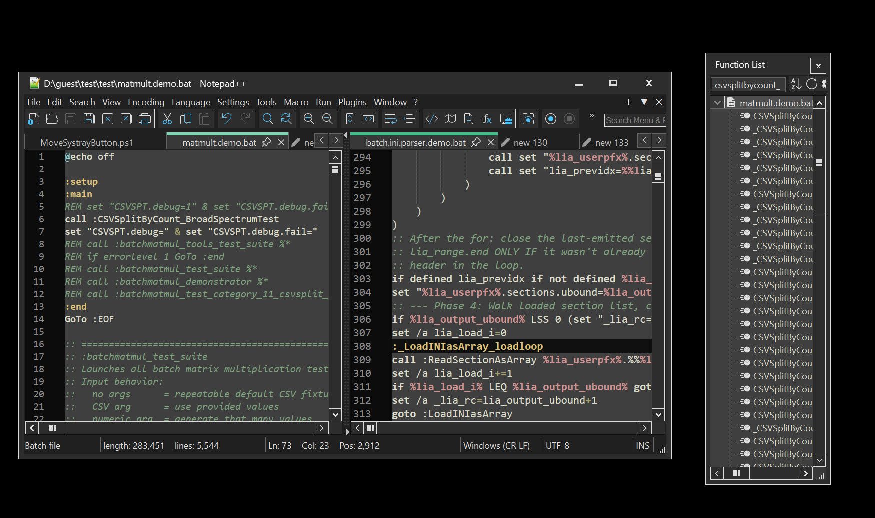

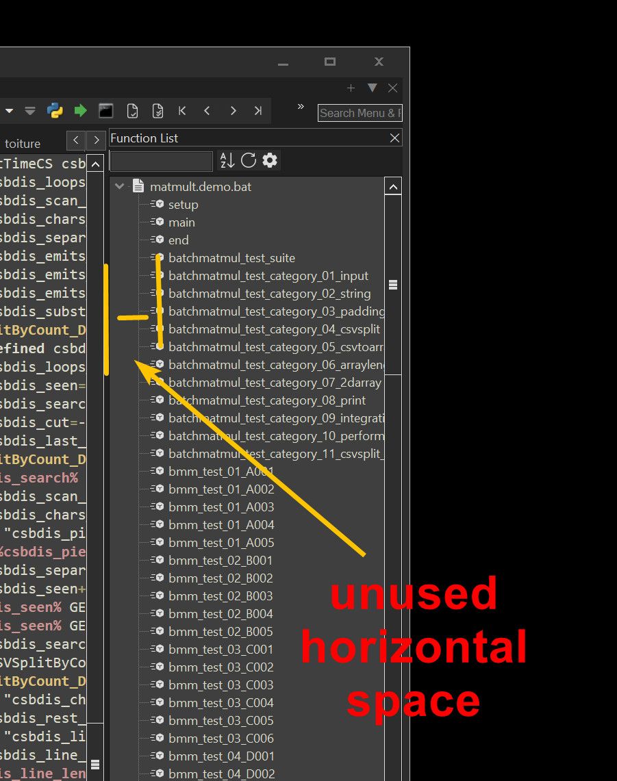

      Unused horizontal space
      It seems there is this horizontal space, maybe it’s useful in another language, but for me, there isn’t anything useful in that space. Maybe it should be reduced somehow ?
      You can use the horizontal scroll
      https://youtu.be/Zyyg1zANWvA
      But it seems to reset all the time, I don’t bother to manually re-adjust every time.
      https://youtu.be/7CnTWWyzR3w
      I would like, to make use of that space, without having to continuously micromanage this.

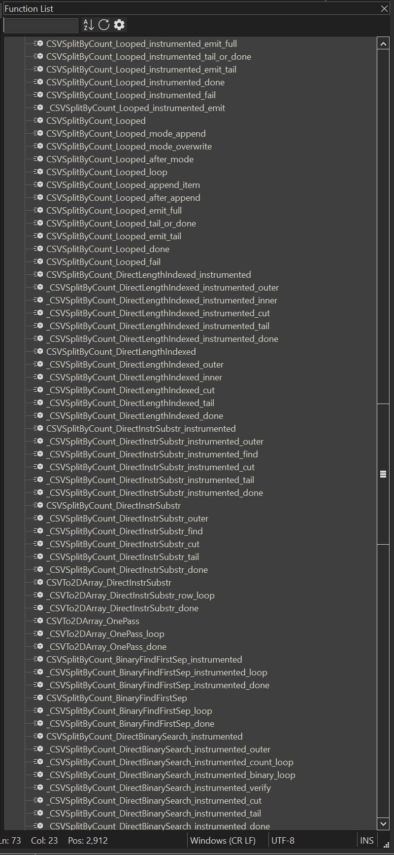

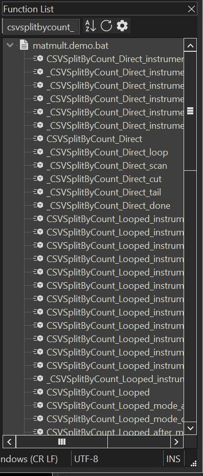

      X. Function filtering
      In my language, functions which begin with “_”
      Are not functions, they are internal labels by convention (this is not part of the language)
      So I have many of these functions that repeat the same function.
      Sometimes there are good navigation markers, but sometimes they just bloat the list.
      It would be great to be able to hide functions that start with “_”. but have a toggle button to show them if I suddenly need them.

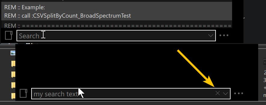

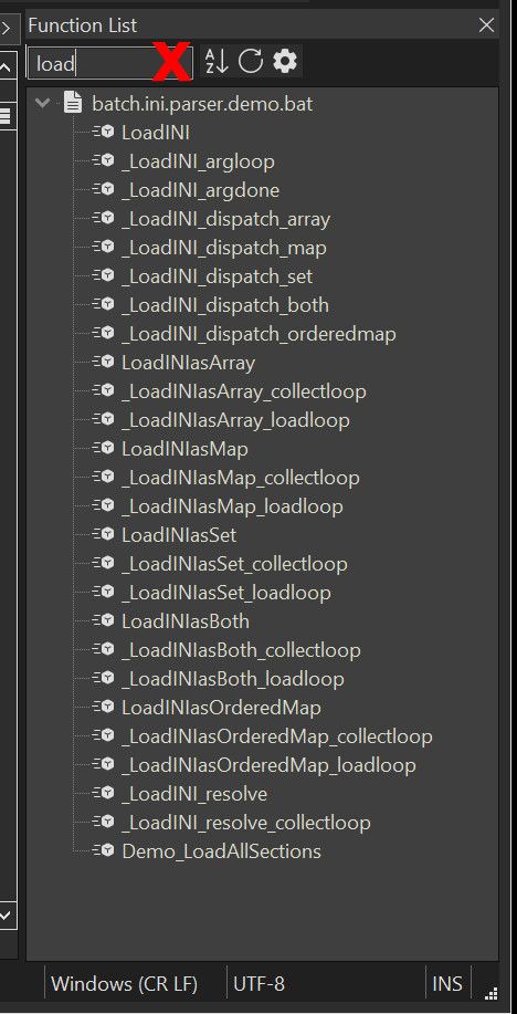

      X. Resetting the function search
      You can type a search, but clearing the function search needs to select and then use the keyboard to delete the text.
      Many software show a clear button in the textbox, when search text is present. This way the search text can be cleared with a single click, rather than select text then press backspace or delete or ESC.
      Here is how I propose to make this easier.
      When there is search text, show an X on top of the text box.
      Example
      So you can just click the X to clear the search.

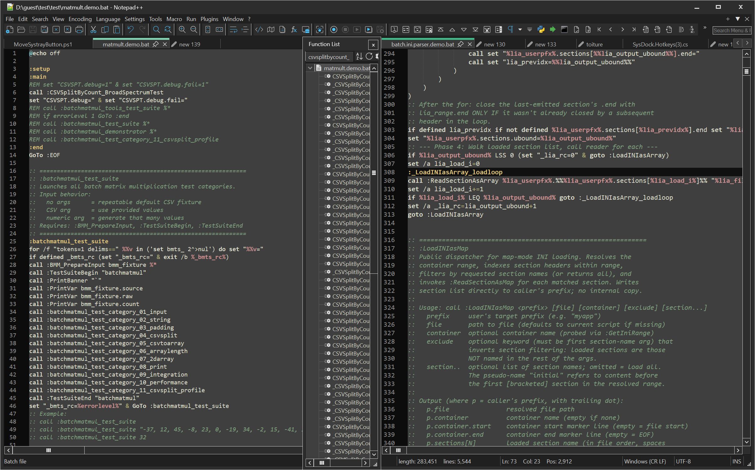

      X. The function search sidebar is somehow, never the right width !
      I don’t know why, but I am constantly adjusting the width of the function search sidebar.
      I don’t know why I can’t just set it once and forget it. Presumably just the right width, I shouldn’t need to touch it again. But somehow, I don’t know what I do, but I do move and resize notepad++ a lot with AltSnap and I end up often having to readjust the function sidebar width.
      And I struggle to hit that narrow width to drag it.
      Beside what could be done to automatically have it be “the right size” automatically.
      I suggest these.
      Make middle-click-drag allow drag-resizing of the sidebar (and maybe the move the other-view separator ?

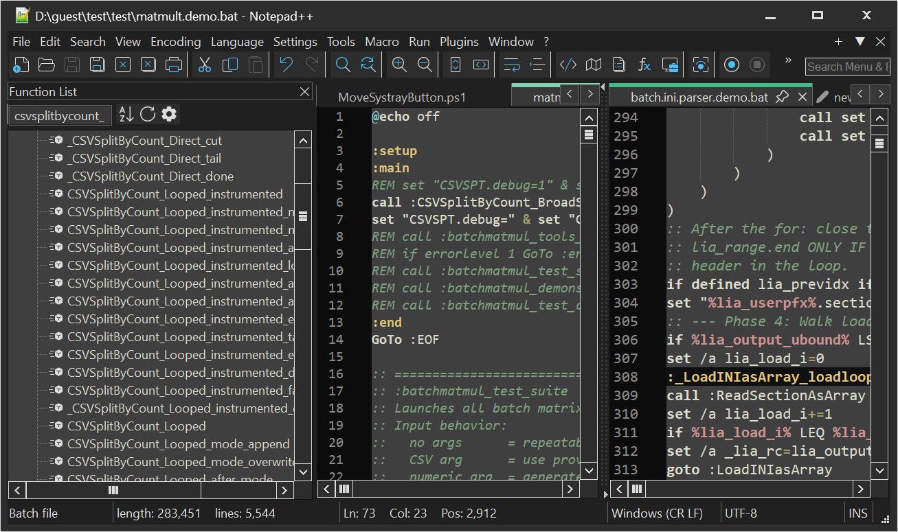

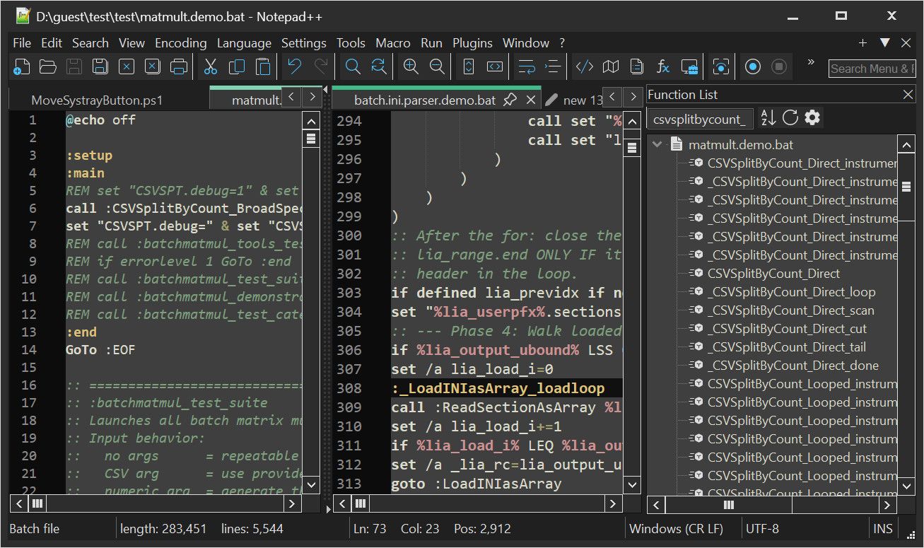

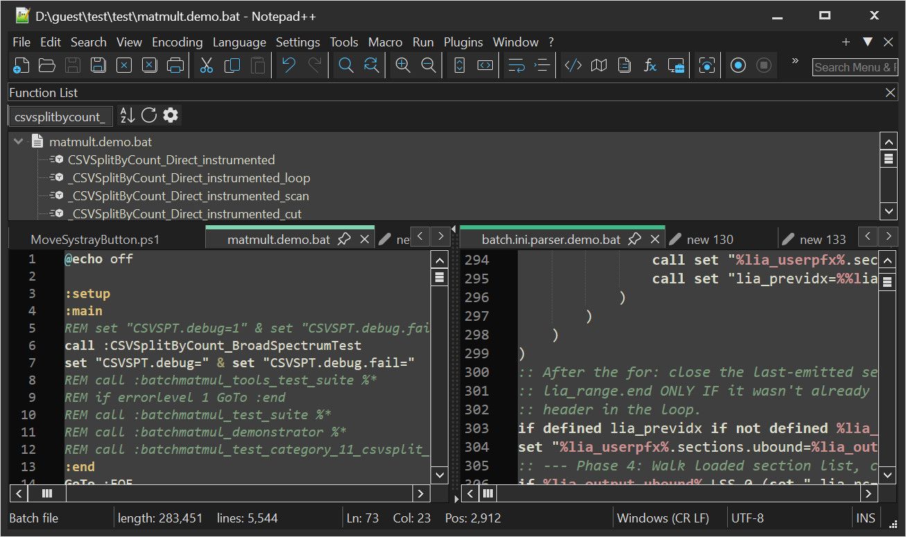

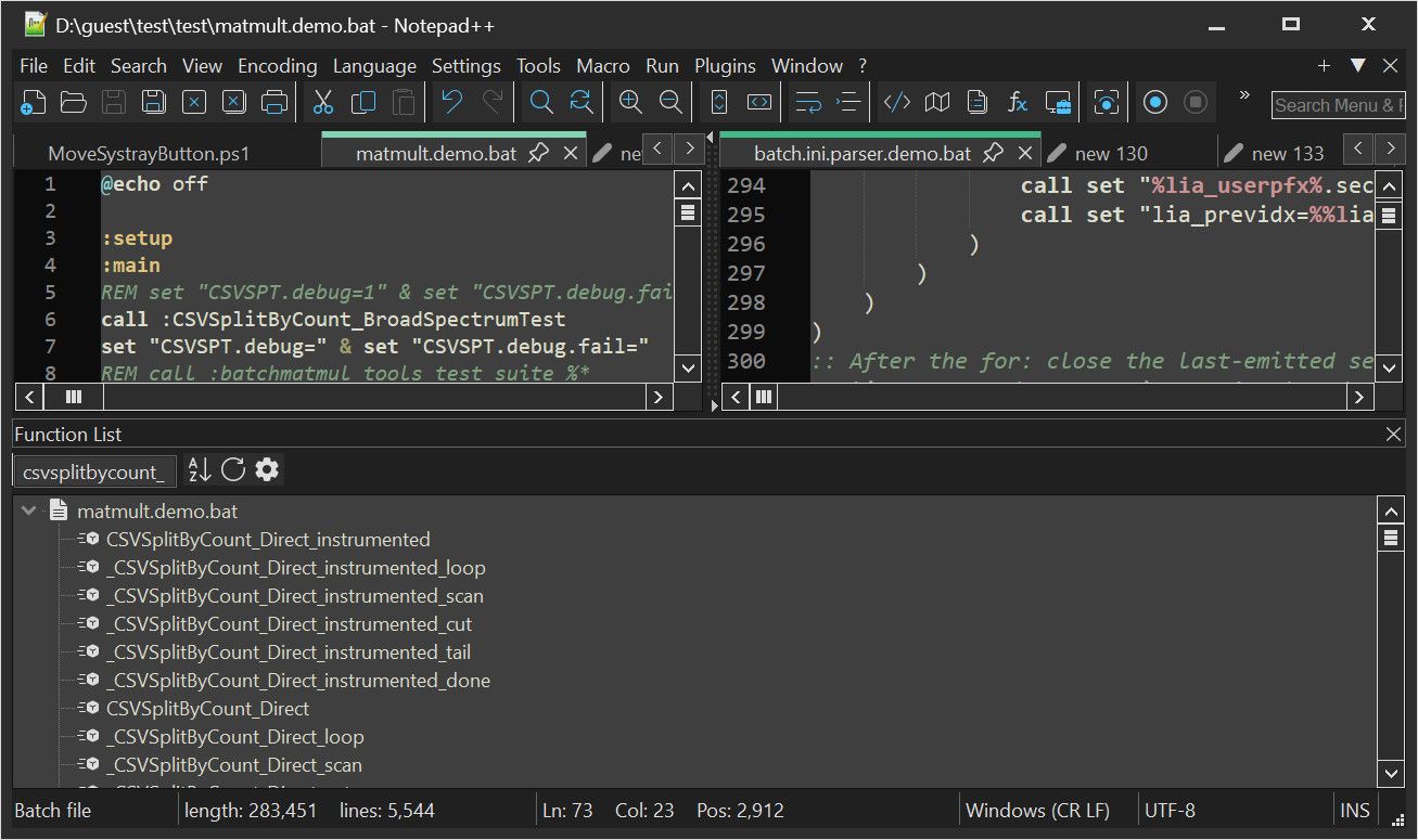

      X. The function sidebar cannot be docked to the other view separator
      You can snap the function search sidebar to the
      right
      left
      top
      bottom
      and even floating
      but not in the middle
        Not by default. But like all menu commands, you can assign one with Shortcut Mapper, if you want one.
        There are more menu entries in Notepad++ than there are keystrokes available, so not every menu entry gets a keystroke.
        As far as I have been able to tell, the way that Notepad++ internally handles shortcuts doesn’t distinguish the left and right alt keys. It’s just “Alt” as the modifier.
        That’s the way that treeview controls generally work. I think it would take a huge amount of development effort to customize or re-create oit.
        In my language, functions which begin with “"
        It would be great to be able to hide functions that start with "
        Interesting feature idea. I’m not sure how easy that would be to implement. But this would be the first thing you said that I would think would be worth putting in an official feature request. (If you think that this Community Forum is the place to make feature requests, you need to read the Feature Request FAQ)
        X. function search length has a maximum !
        I haven’t used the function search feature enough to be able to comment on those. If other users agree with you on those items, they could each go in as separate feature requests.
        I don’t know that there’s anything the developer can do to fix that. If you are accidentally resizing it, he cannot prevent it. The docking panels are designed to be resizable.
        Hmm… Do you have a high-DPI monitor? Because on my old-fashioned 100%-scaling setup, it seems to me to be the same width as any size resize control in any windows application.
        “The right size” is meaningless. Everyone disagrees on what that would be, which is why it’s user controlled. Besides, all the docking panels share the same basic control, and everything docked on the right (for example) shares the same width… so what would be “perfect” (in your opinion) for the FunctionList on the right might be too small for the DocumentList (for example) on the right.
