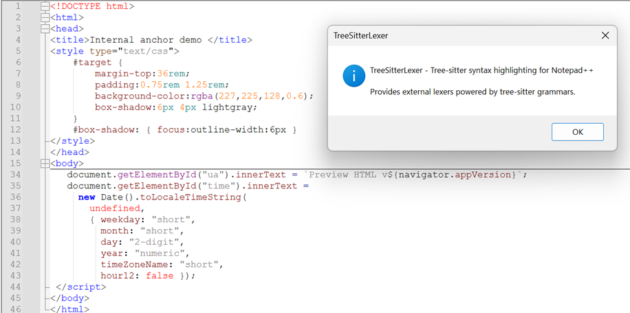

              For now, a relatively simple way to edit HTML documents with embedded style and script highlighting is to use the tree-sitter plugin.
              Note that only “light” style themes are currently supported, and you will have to manually download and extract the configuration files to get it working.
