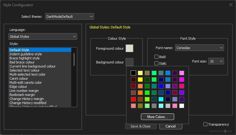

        Oh, and if after this issue is solved, how do I set the general screen background to the the darkest black rather than the sort of gray that it was at when I chose Dark Mode, before I wrecked that?
        Settings > Style Configurator > Language: Global Styles > Style: Default Style, then click on the background color box, and select the true black:
