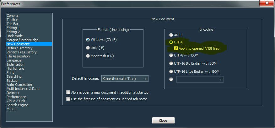

        The problem is that neither ANSI nor UTF-8 includes a “marker” within the file itself to indicate the encoding type. This means Notepad++ or any other editor has to determine the encoding based on the file’s content. Consequently, with an empty file, it is impossible to distinguish which encoding is intended.
        That is precisely why this setting exists (see screenshot). Checking that box should do the trick.

          Screenshot with englisch lang:

            ok, thank you. This works.
            I must have been blind to not see that sub option.

                  The option is on the “New Document” panel, no doubt, because it is only available when the default encoding for new documents is set to UTF-8.
                  Yet it doesn’t apply to new documents, it applies to existing files.
                  What is really means is, when Notepad++ opens an existing file that contains only ASCII characters, it should treat it as UTF-8 rather than as ANSI.

                  This setting lets you tell Notepad++ whether it should load pure ASCII files so that, if you add non-ASCII characters to them, they will wind up as ANSI, or so that they will wind up as UTF-8.
                    Yeah, so for example: “Treat ASCII-only files as UTF-8 (instead of ANSI)” or something similar could be a more clear wording for the option.
