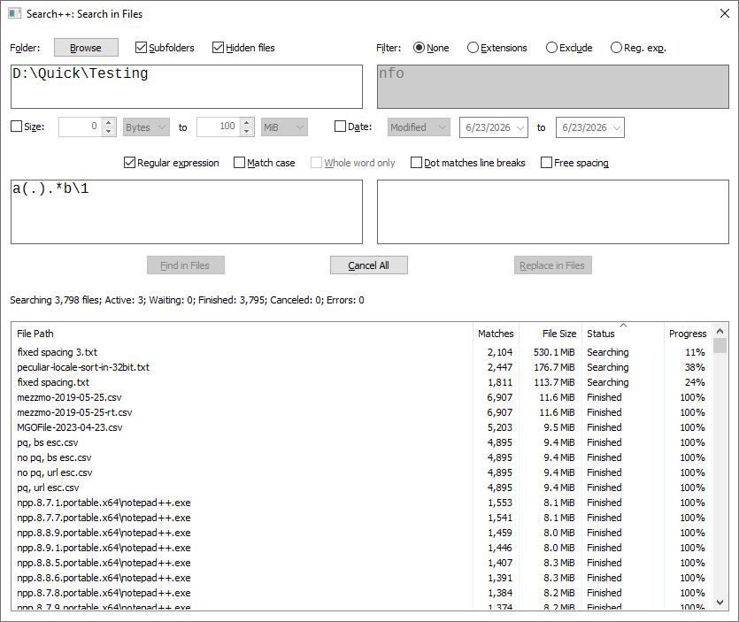

                            Search++ version 0.6 is available.
                            The big change in this version is the addition of a Search in Files dialog:
                            There have been a few small fixes elsewhere — by now I’ve forgotten what they were — but mostly this release is for Find in Files. Adding that led to quite a few changes in code it shares with the existing functions, so unfortunately there could be new bugs in old functions. On the whole, though, handling of the search results list should be improved for all functions that use it.
                            If you don’t like to read help, at least don’t forget to try right-clicking the text entry boxes and items in the file list.
                            Replace in Files is planned but not yet implemented.
                              Hello, @coises and All,
                              First, many thanks for adding the Find in Files capability within the Search++ plugin. In addition, this search dialog allows you to filter by date range and/or size and also to choose or exclude some extensions !
                              Regarding the Search++ Search in Files dialog :
                              To my mind, the magic option is the last Filter Reg. Exp. option. Indeed, for example, from my USB key named D:, I typed in the text below, in the Filters zone :
                              ^890_x64\\.+\.log$|^862_x64\\|^C.*\.txt
                              Then, the search scope would be :
                              • All the .log files in the 890_x64 arborescence of D:
                              • All files of the 862_x64 folder of D:
                              • All the txt files, from the root ( D: ), whose name starts with a letter C
                              It’s important to emphasize that the Filters search is always a NON-SENSITIVE search. Thus, given the example above, the search would occur on file D:\..\...\...\Test.LOG and on file D:\current.txt. This remark also applies to the Extensions and Exclude options !
                              In order to search in a specific folder, named Music of my USB key, I have two possibilities :

                                Coises @guy038
                                Thank you for trying it!
                                I made it that way by default since file and folder names are not case sensitive in Windows. You can still prefix the expression with (?-i) to make it case sensitive. I don’t know if the API I use to retrieve file paths from a folder is guaranteed always to return names in the correct case, but it appears that it does.
                                Now, is there a particular reason for not allowing the ICU search ?
                                Just the same as before — allocation of time and effort. ICU is not a “drop-in replacement” for Boost::regex; it would have significantly delayed me being able to release a public version of this had I included ICU search. Since Notepad++ users are already familiar with Boost::regex syntax, and I am more familiar with its programming interface (and so can work with it more quickly than ICU), I have prioritized Boost::regex.
                                I am not ruling out adding it later. I will say, though, that I plan to study and attempt to incorporate its useful unique features into Boost::regex before spending too much time trying to implement additional ICU search variants of Search++ functions. It remains to be seen whether I can successfully fork Boost::regex and extend/enhance it to make the ICU search option redundant. It definitely helps me that you are making note of ICU features you miss in Boost::regex.
                                Regarding the Search++ Results dialog :
                                • Would it be possible to add a Purge option, like in the context menu of the N++ Search results dialog ? You could use the same label Purge for every search or some equivalent ( I do like Purge before each search )
                                That makes sense and sounds possible. I’ll add it.
                                • Although written in your files list, I also noted that the number of scanned files is not reported in the Search++ Results** dialog, unlike with the N++ **Search results` dialog
                                And, if possible, it would be best to include the chosen options of the current regex too, like Regex, Case,... ?!
                                Agreed. I’ll add that information.
                                To end with, I noticed that, within the N++ Search results, it is possible to easily see all files which has matches, without seeing the matched lines :
                                • By hitting Ctrl and clicking on ⊟, on the first line => The search collapsed after some time and then with a simple click on ⊞
                                • By using the Fold All option of the Context dialog and then a simple click on ⊞ of the first line
                                I see your point. There is some flexibility missing. I will look for a way to make that easy to do.

                                      Search++ version 0.6.1 is available.
                                      This update enhances the Search++ Results list, including adding more detail to the search headers, implementing an “automatically purge” toggle and recognizing single-click in the margin.
                                      All comments, critiques and thoughts are welcome!
                                      This update addresses all those points. See the help for details about the commands in the results list.
                                      I’m not handling folding quite the same way as Notepad++ does. (It could be that in time I will decide to try to emulate Notepad++’s appearance and behavior more closely.) What I did was add a context menu option (also available as Shift+Enter or Shift+double-click) for search header lines that toggles the fold state of all documents in that search without folding the search itself. So if you select Expand/Collapse Search, or double-click, the search folds or unfolds with the folding of documents within it unchanged. If you select Expand/Collapse Documents, or Shift+double-click, when the search is expanded, all documents within that search either expand or collapse (the opposite of whatever is the state of the first document).
                                      I added a few other things, like clicking in a margin being equivalent to double-clicking in a header line or on the first position in a detail line. There is a purge toggle now, and search header lines include information about how many files were searched and the type of search (including modifiers).
