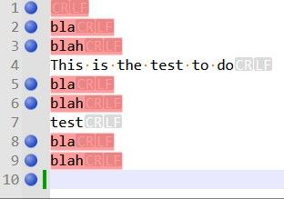

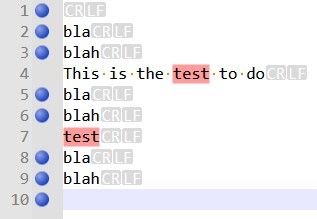

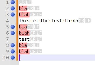

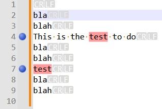

                        Hi, @coises,
                        I’ve just tested your new v.0.7.1 release !
                        Let’s suppose that we marked the occurrences of the word test in the text below, that you’ll paste in a new tab :
                        bla
                        blah
                        This is the test to do
                        bla
                        blah
                        test
                        bla
                        blah
                        And that we checked the Bookmark lines when marking text (Shift: configure option, in the Tools menu
                        => The line 4 and 7 are bookmarked and the two occurrences of the word test are marked
                        In an old post, I said that, in order to get the complementary regex, we had to use the ^((?!test).)*$ regex as below :
                        Luckily, there’s no need to find out this complementary regex, anymore :
                        • First, mark all the occurrences of the word test.
                        • Right-click within the bookmark margin of N++ and choose the Inverse bookmarks option.
                        • Then, go to the Synchronize marks and bookmarks option of the Tools menu and choose the Mark all text in bookmarked lines and clear other marks option
                        => You should get this snapshot :
                        Which correctly bookmarked all the lines not containing the word test and then marked all contents of the bookmarked lines, including the EOLs, as well !

                              The only way to bookmark the last empty line 10, that I found, is to use the regex ^((?!test).)*$ again my example text, below :
                              bla
                              blah
                              bla
                              blah
                              test
                              bla
                              blah
                              Some observations :
                              • Using Search++, in mode Regex, this regex counts 8 matches, whose line 1 with ONLY a small blue triangle at bottom of line 1 and the last empty line 10 with the calltip ^ zero length match
                              • Using Columns++, this regex counts also 8 matches, but, this time, the first line returns, instead, the calltip ^ zero length match
                              • Using Search++, in mode ICU this regex counts 7 matches, whose line 1 with ONLY a small blue triangle at bottom of line 1. So the line 10 is not a match

                              Thus, in all cases, all the marked text and all the bookmarked lines should be wiped out before a new Mark command.
                              Using my example text, described above, I marked, in ICU mode, all the lines which match the regex ^\n|Q, as shown in the snapshot below :
                              Then, I simply searched for the ^\n regex. As noticed above, this regex finds nothing. However, after clicking on the Mark in Whole document option, the previous marks and bookmarks remain unchanged ?
                              I expected no marked text and no bookmrked line ! I suppose it’s a bug.
                                  Yes, that’s the bug you found. The precise conditions are that if a match includes the last character in the file, Search++ fails to check for the possibility of a null match at the end of the file. That will be fixed in the next release.
                                  Yes. Where possible I use the small triangle to mark a zero-length match. There are two situations where that isn’t possible, due to Scintilla limitations: when the match is at the end of a line, before the line ending characters, and line ending characters are not shown; and when the match is at the very end of the file. In those cases, I use the ^ zero length match banner instead.
                                  I use triangles for zero length matches in the Search++ results list and with the Show command, too. The same limitations apply with Show, but because call tips disappear when you interact with the text, I can’t really do anything about the indicators you can’t see. In the results list you can always see them because I can safely change some settings so that I can use line ending characters that Scintilla considers displayed, but that don’t actually show anything you can see.
                                  Yes, I hadn’t thought of the triangle method yet when I wrote Columns++.
                                  As best I can tell, ICU’s regex engine does not consider the position following the last character in the document to be the beginning of line, regardless of whether the last character is a line ending character. That makes sense, really, but it doesn’t conform to the way Scintilla lays out lines. So your expression doesn’t match because the circumflex doesn’t match.

                                  It is working as intended, but perhaps the design is confusing. I had to keep the text in the Settings dialog reasonably brief, but I see I didn’t describe the details correctly in the help.
                                  Existing marks (and bookmarks, if applicable) are cleared if the command is successful, meaning it finds at least one match. (Internally, it waits until it finds the first match and only clears the existing marks after it has found the first match, but before it marks it.) If there is an error, or if no match is found, nothing is cleared.
                                  Since you can’t “undo” changes in marks and bookmarks, I thought that at least in the case where someone mistypes a search string resulting in no matches, it would be better not to lose the marks (or selections, or shown text and lines, as the case might be), so one could easily try again.
