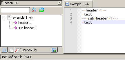

        thanks a lot for your reply. I changed functionList.xml to
        <functionName>
        	<nameExpr expr="(?-s)^=+.*=+$"/>
        </functionName>
        and now the Function LIst looks different:
        = header 1 =
        The first headline looks good, but the next is missing. This is only a short example - in my real file all headers are missing except the first one.
        Do you have any ideas ?
        Thanks,
        Christian

            Hi,
            sorry - with that mainExpr the function list stays empty.
            One funny thing I realized: when I use my initial expression
            in the search dialog then it works - it finds every single row. Can it be that the parser for the functionList.xml behaves differently than the parser in the search dialog ?
            Thanks,
            Christian

              • C Offline
                Christian11235
                to 1: Yes - I assumed this.
                to 2: Yes - this was the case from the beginning.
                To clarify: the problem ist not that the parsing is not working at all - the problem ist that not all headlines are found. Till now I only have regular expressions which either find
                • the first headline
                  expr=“(?-s)^=+.*=+$”
                • all headlines but take them for one headline
                  expr=“^=+.*=+$”
                Thanks,
                Christian

                  • C Offline
                    Christian11235
                    Hi,
                    both expressions only show the first header. All headlines after the first header are ignored.
                    My testfile has the name tst.wik and looks like this
