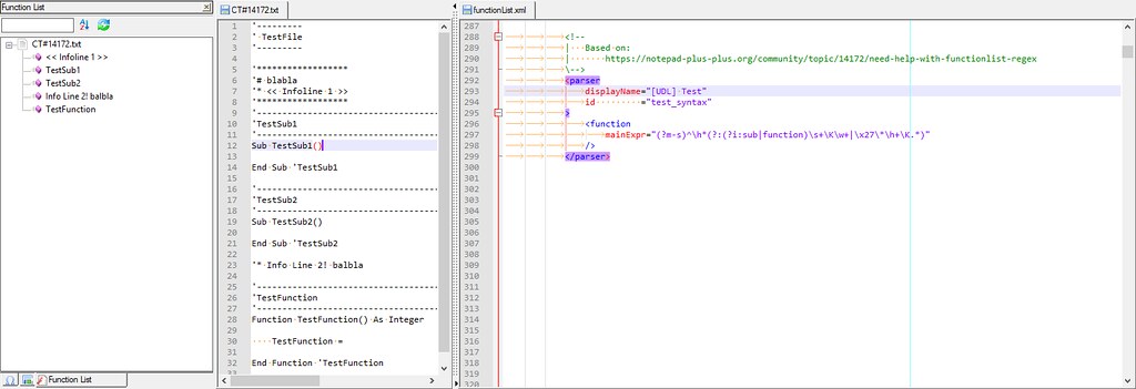

      Hi,
      for a userdefinde language I try to use the functionlist. For the subs/functions this is already working. But I want to see in the function list also some special markings/infos.
      This is an example:
      ' TestFile
      '# blabla
      '* << Infoline 1 >>
      'TestSub1
      Sub TestSub1()
      End Sub 'TestSub1
      'TestSub2
      Sub TestSub2()
      End Sub 'TestSub2
      '* Info Line 2! balbla
      'TestFunction
      Function TestFunction() As Integer
      	TestFunction =
      End Function 'TestFunction
      With this parser:
      			<function
      				mainExpr="^\s*(sub|function)\s+\K\w+"
      			</function>
      I get this list at the moment:
      • TestSub1
      • TestSub2
      • TestFunction
      What I want is
      • << Infoline 1 >>
      • TestSub1
      • TestSub2
      • Info Line 2! balbla
      • TestFunction
      I tried this one
      			<function
      				mainExpr="^\s*((sub|function)\s+\K\w+|('*)\s+\K.*)"
      			</function>
      but without success. Then nothing show up anymore in the list. Can someone help me with this? Thank you.

                    Hello, @madill, @mapje71,
                    I found a solution :-)) To test it :
                    • Open, in N++, your active functionList.xml file
                    • Add the line, below, inside the <associationMap> node :
                    			<association id= "Test" langID="0" />
                    • Add the lines of the Test parser, below, inside the <parsers> node :
                    			<parser	id ="Test" displayName="Ma_Dill_Test" commentExpr="'(?!\* )(?-s:.+)" >
                    				<function
                    					mainExpr="^\s*(sub|function)\s+\K\w+|^'\*\s+\K(?-s:.+)" >
                    				</function>
                    			</parser>
                    • Save the changes of functionList.xml
                    • Close and re-start Notepad++
                    • Open a new tab
                    • Copy your example text of your first post, in this new tab
                    • Open the Function List panel ( View > Function List )
                    => You should see your five functions, as you expect to !!
                    Notes :
                    • I preferred to add the commentExpr part, which defines the line-comment zones to avoid, for further search of functions !
                    • As I supposed that lines, beginning with '* followed by some space characters, define special marking/infos
                      it becomes obvious that comment lines are lines which :
                      • Begin by a single quote character ( ' ), NOT followed by an asterisk + a “space” character '(?!\* ), which is a negative look-ahead
                      • And followed by all standard characters of the current line => (?-s:.+). The -s modifier is needed, because, by default, the Function List Regex engine considers all the text as a single line. ( So the regex .+ would match any non-empty text, even on several lines. That is to say, all file contents ! )
                    • In the mainExpr regex, I just add the alternative ^'\*\s+\K(?-s).+, which looks, after beginning of line, for :
                      • A single quote, followed with an *asterisk ( '\* ) and, at least, one character, of type = “space” ( \s+ )
                      • Then, the syntax \K resets the regex search
                      • Finally, the part (?-s:.+), again, looks for the remainder of the current line, only, due to the -s modifier, and is simply displayed, in the functionList panel !
                    BTW, Mapje71, the differences between your two posts, are the part (?m-s), at beginning of the regex, in your last post ;-))

                      @guy038 and @MAPJe71 The version from guy038 is working. I don’t know why the other one is working on your screenshot but not here. Thank you to both for your time and help. How can I set the topic to solved?
                        Hi, @madill, @mapje71, and All,
                        Updated on 07-22-17 ( \v syntax added )
                        MaDill, I, slightly, changed the mainExpr regex, as below :
                        (?i)^\h*(?:(?-i:Sub|Function)\s+\K\w+|'\*\s+\K(?-s:.+))
                        Notes :
                        • At beginning, the part (?i)^\h* means that the search is, globally, case insensitive and that the key-words ( Sub, Function and '* may be preceded by optional tabulation and/or space characters
                        • Then, the general structure, which follows, is a non-capturing group, made of two alternatives ( (?:.....|......) )
                        , As I thought that the key-words Sub and Function must have that strict case, I decided to create the sensitive non-capturing group (?-i:Sub|Function)
                        • Any key-words must be followed by, at least, one, horizontal or vertical, White Space character ( \s+ )
                        • Finally, after the reset behaviour, due to the \K syntax, we display, in the Function List panel, either :
                          • The name of current subroutine or function ( \w+, in case of key-words Sub/Function
                          • All the rest of current line, only, (?-s:.+), in case of key-word '\*
                        Do hope, you’ll like this interpretation ;-))
