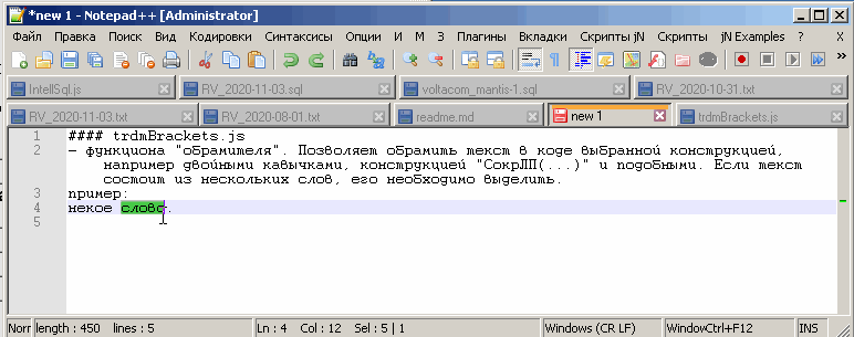

            I do a similar job using MS Excel and its Concatenate function.
            I have a trdmBrackets.js script in my repository that does a similar job, but to select either one line.

                  My script works in conjunction with the jN plugin as well as some ActiveX, so its installation is difficult for a beginner. Additionally, I just made edits in the local repository to frame all lines. You will need to update the repo on GitHib.

                      A script feels a bit “heavy” for this simple operation.
                      This is if we mean only this operation.
                      In fact, there are many possibilities as the brackets are customizable.
                      Often it is necessary, for example: to complete the lines on the right or left.
