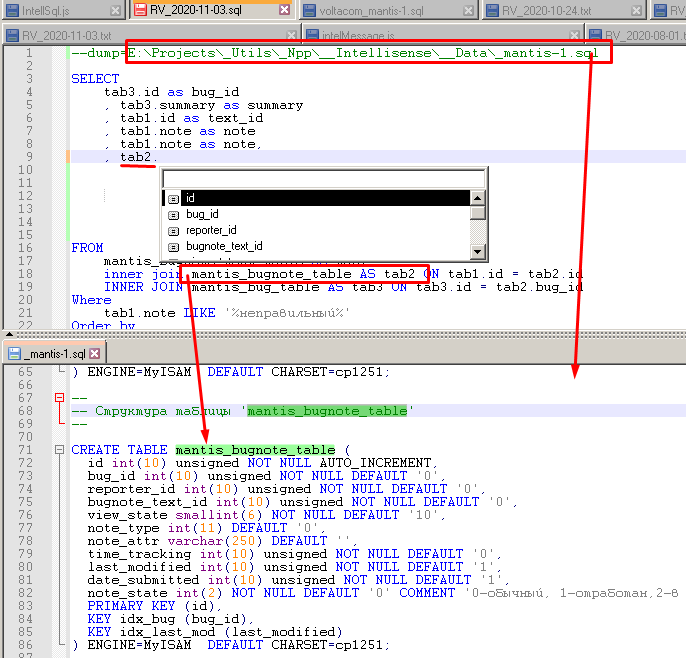

                                  No, I have no experience with sql language servers. I found this one , but it’s archived.
                                  Just a small example of what can be done. A “real” service would of course have to address all the problems already mentioned.
                                  the missing part of the sqlite db

                                    I touched it up a bit just to illustrate how user input can be bound to a prepared statement; that way completions will reflect any live changes from DDL queries that DROP, CREATE or ALTER tables.

                                        Описание
                                        I have a project that may interest you jn-npp-scripts . He rudely responds some functionality you mentioned. The main language of this project is Javascript.
                                        The project was built on the basis of another project ( jn-npp-plugin ).
