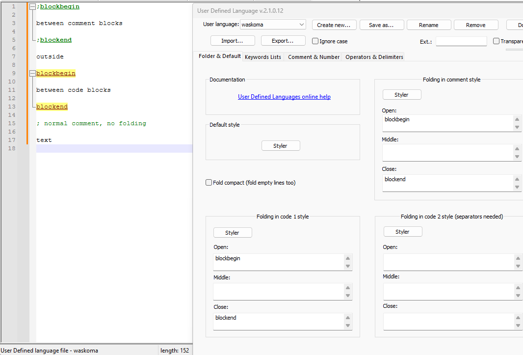

          PeterJones @waskoma
          @waskoma said in strings starting with “;” ignored when given in codeblock start/end string definition:
          compiler which uses ; for comments
          I hadn’t remembered that you said it was in comments. You can have a separate definition for comment-based folding compared to code-based folding.
          WIth example text
          ;blockbegin
          between comment blocks
          ;blockend
          outside
          blockbegin
          between code blocks
          blockend
          ; normal comment, no folding
          text
          1. Folding in Code 1 Style:
            • Styler = deep red foreground, pale yellow background; underline
            • Open = blockbegin
            • Close = blockend
          2. Folding in Comment Style:
            • Styler = green foreground, bold, underline
            • Open = blockbegin
            • Close = blockend
          3. Comment & Number tab > Comment line style:
            • Styler = green
            • Open = ;

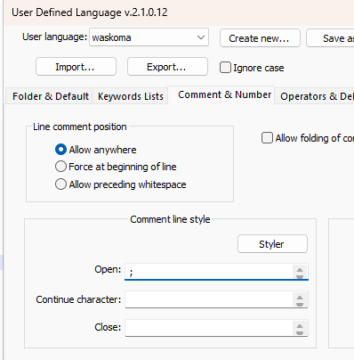

            previously I have made a mistake with the screenshot, just to show you it really doesnt work:
            Secondly, I have realised what is the problem: Notepad++ decided to ignore “;” for codeblock string because I have defined it as comment. But that is just stupid, “;” is comment for the compiler and NOT for Notepad++ :D :(

              PeterJones @waskoma
              As my followon post suggested, I think that what you really want is “folding in comment”, not “folding in code 1”. That would allow you to syntax-highlight a normal comment and allow the blockbegin/blockend inside your comment to cause folding… the best of both worlds.

              • waskomaW Offline
                waskoma @PeterJones
                @PeterJones oh sorry, now I understand. can you send me a screenshot on how you achieved that:? I am unable to replicate it
                • waskomaW Offline
                  waskoma @PeterJones
                  @PeterJones ok sorry, and thank you for your patience, you have explained exactly what to do, and I’ve failed to understand, I’ve got the flu and my brain doesnt operate normally :D
                  so I have managed to achieve it and am REALLY happy. Gave up solving this a long long time ago (have already asked here and got answer it can not be done)
