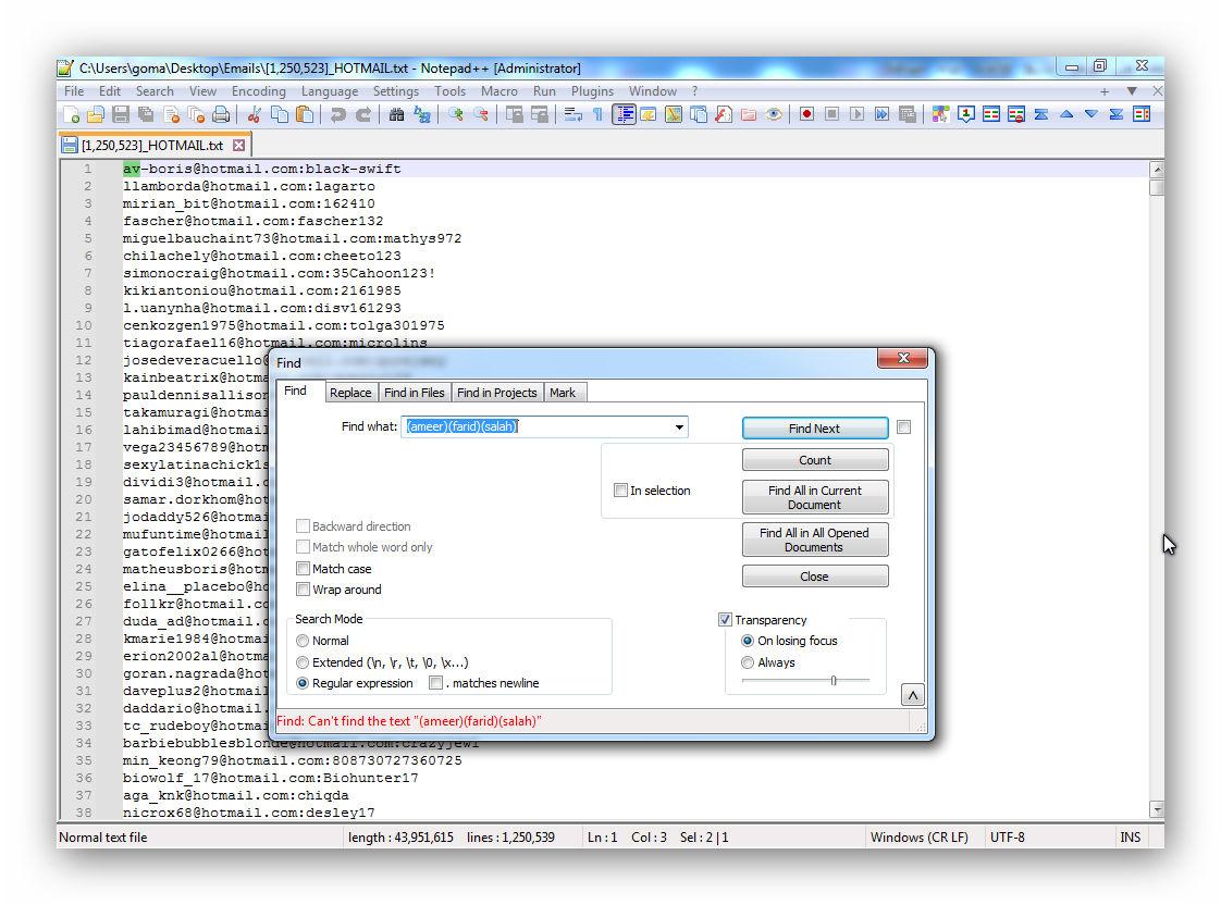

        The method did not work for me
        No names found

            @sabry-farg said in How do I search for multiple names at once? Notebad++:
            That’s because you didn’t read and/or can’t follow instructions.
            You were told that this is what to search for, in general: (a)|(b)|(c)
            You searched for (a)(b)(c).
            Thus, “did not work”.
