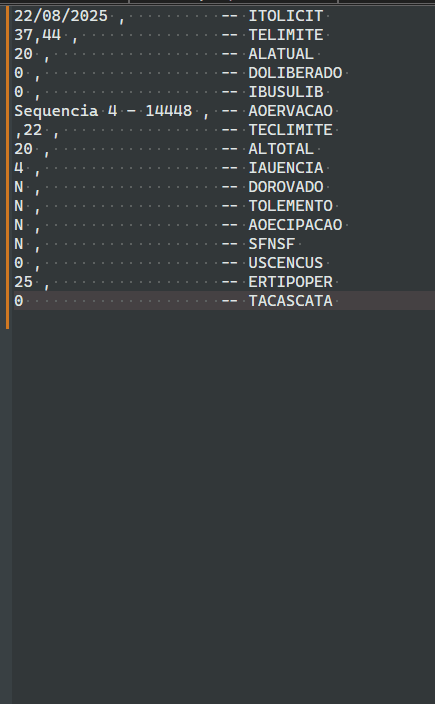

        I am having the same problem. I tried with versions v8.8.3 and v8.7.7, can somebody else reproduce this?
          Coises @notdodgeball
          @notdodgeball said in npp v8.6 reverses the order of lines on column copy/paste:
          Yes. However, it is not a bug, but a “feature.”
          Column selections are expected to retain their physical order regardless of the direction in which they were selected. That’s what the earlier part of this thread concerned.
          You made a zero-width column selection, but then (I think) you pressed Shift+End. That converted the column selection to a multiple selection. You can see that because the carets at the end of each line are not lined up. A column selection would be a rectangle that included the empty space at the end of shorter lines and had all the flashing carets lined up.
          Multiple selections regard the order in which the selections were made. Even though you started as a column selection, the fact that you started at the bottom and extended to the top is “remembered” when you change it to a multiple selection. So the bottom line is “first,” and that’s how it’s pasted.
          If you wanted to extend your zero-width column selection to the right, you would have had to use Alt+Shift+right arrow until you got it as wide as desired (or just make the original selection by doing a click at one corner and an Alt+Shift+click at the diagonally opposite corner).
