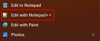

      I am missing the “Edit with Notepad++” option from the (new Windows 11) right click context menu. Check out the screenshot below:
      From another computer I know that this option was added to Windows 11 a year ago so it should be present.
      The computer that is having the problem is a Windows 11 machine that was inplace upgraded from Windows 10. I have uninstalled Notepad++ with the option to remove all personal settings. I then reinstalled Notepad++ but the option is still missing from my context menu. Is this expected behavior? Can I manually fix this?
