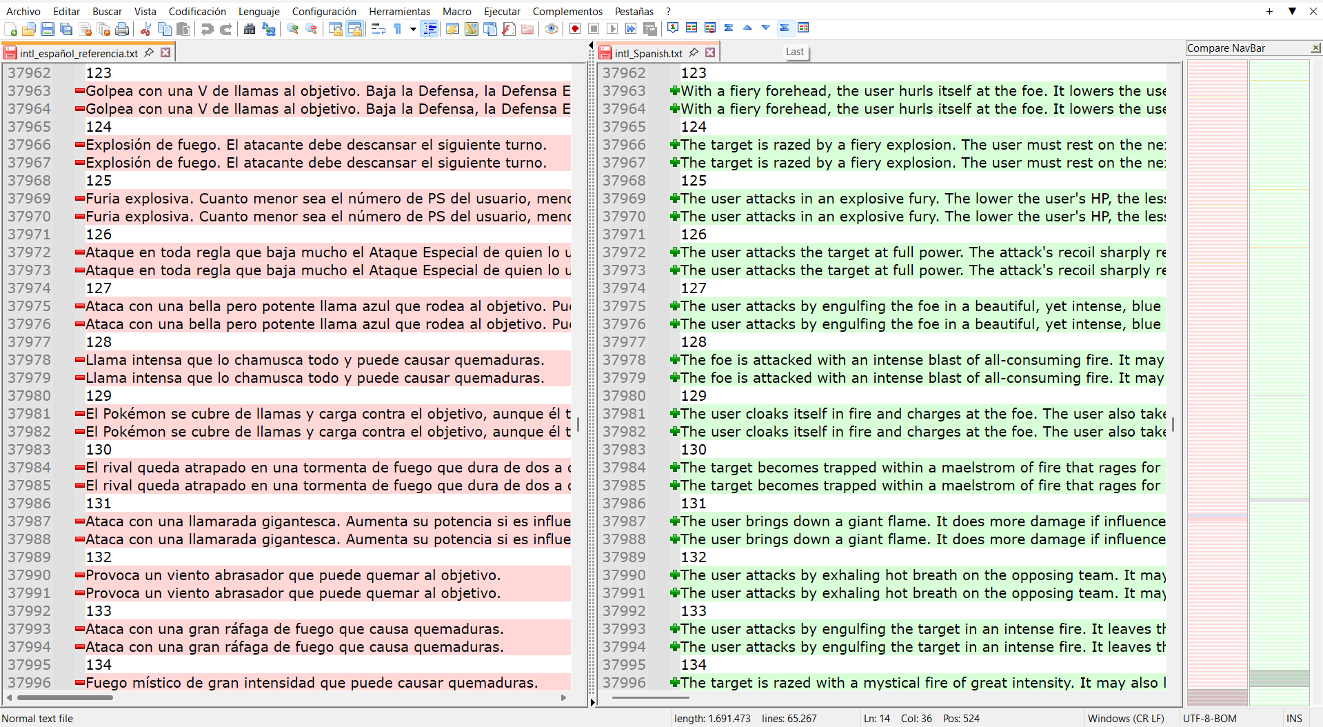

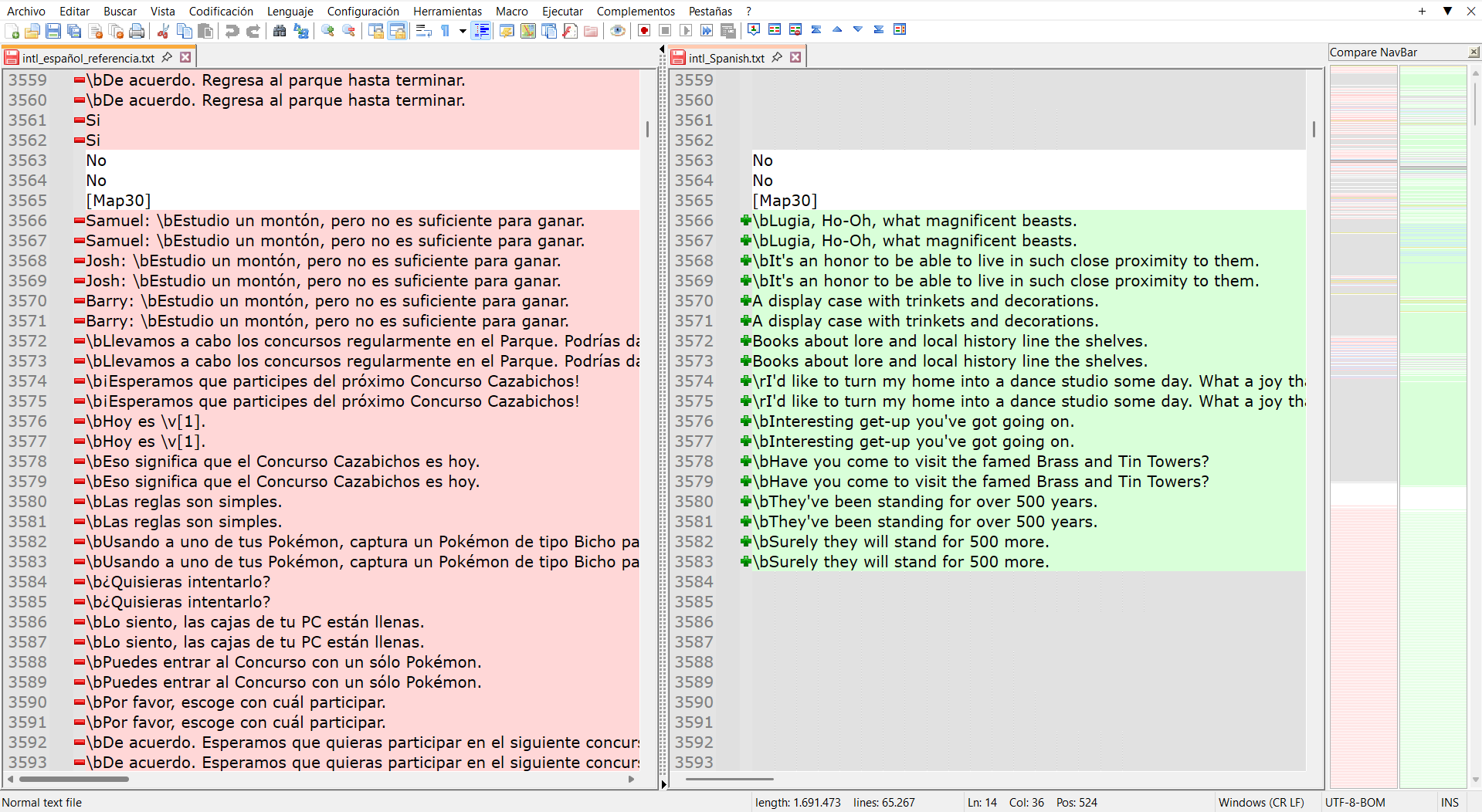

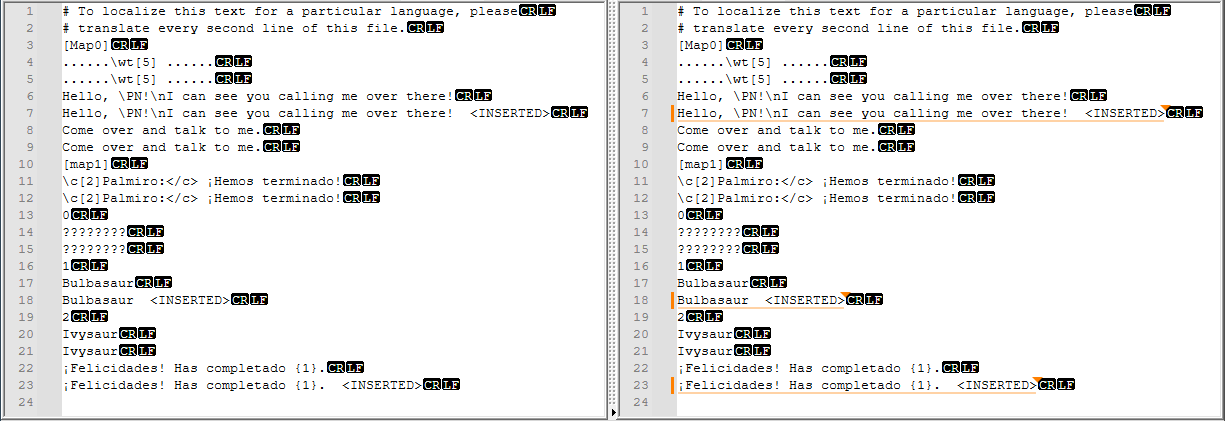

    Hello! So, I’m translating a really big file for a Pokémon RPG Maker game, and I’m using two files: one in Spanish and another one in English.
    The thing is, lots of the lines just need to be copypasted from one file to the other one, and double-clicking got old pretty fast. I’m trying to find a way of doing this as quick as possible to prevent burning myself out, but I haven’t found a good method of doing so.
    As you can see, the Spanish file is on the left and the English one on the right. I need to copy/translate the second lines of the English file and leave the first ones untouched, and I figured that I could double-click those lines on the Spanish file, pressing ctrl to select multiple ones, and doing the same thing on the right but pasting them.
    …But, as I wrote before, it’s just a pain.
    I found a program called “Meld”, and while it kind of does what I want, it’s a bit slow and it doesn’t replace just the second line, but both of them.
    The question is: is there a plugin that could help me do what I’m looking for? It’s my first time using Notepad++, so I’m a bit lost here.
    Thanks!

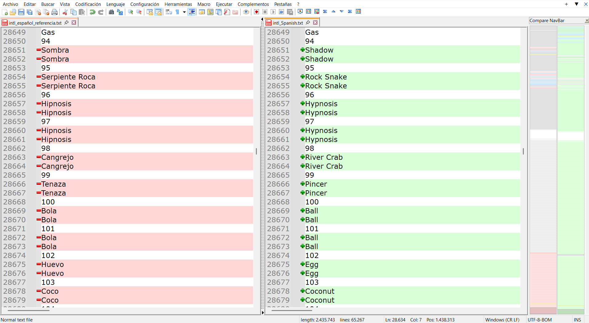

      It would help if you had shown an example of exactly what you want the final result to look like, because I found your explanation confusing.
      To clarify, based on the example above, the final result would look like the below, correct?
      Gas
      94
      Sombra
      Sombra,Shadow
      95
      Serpiente Roca
      Serpiente Roca,Rock Snake
      If you continue to ask for help without showing examples of what you want, I suspect that other forum regulars will lose interest in helping you.
      D 1 Reply Last reply May 29, 2025, 4:22 PM Reply Quote 2

        @Mark-Olson I’m so sorry! I was so focused on the problem that I forgot to show exactly what I’m looking for.
        It would be something like this:
        94
        Shadow
        Sombra
        95
        Rock Snake
        Serpiente Roca
        96
        Hypnosis
        Hipnosis
        Thank you!
        C M 2 Replies Last reply May 29, 2025, 5:29 PM Reply Quote 1

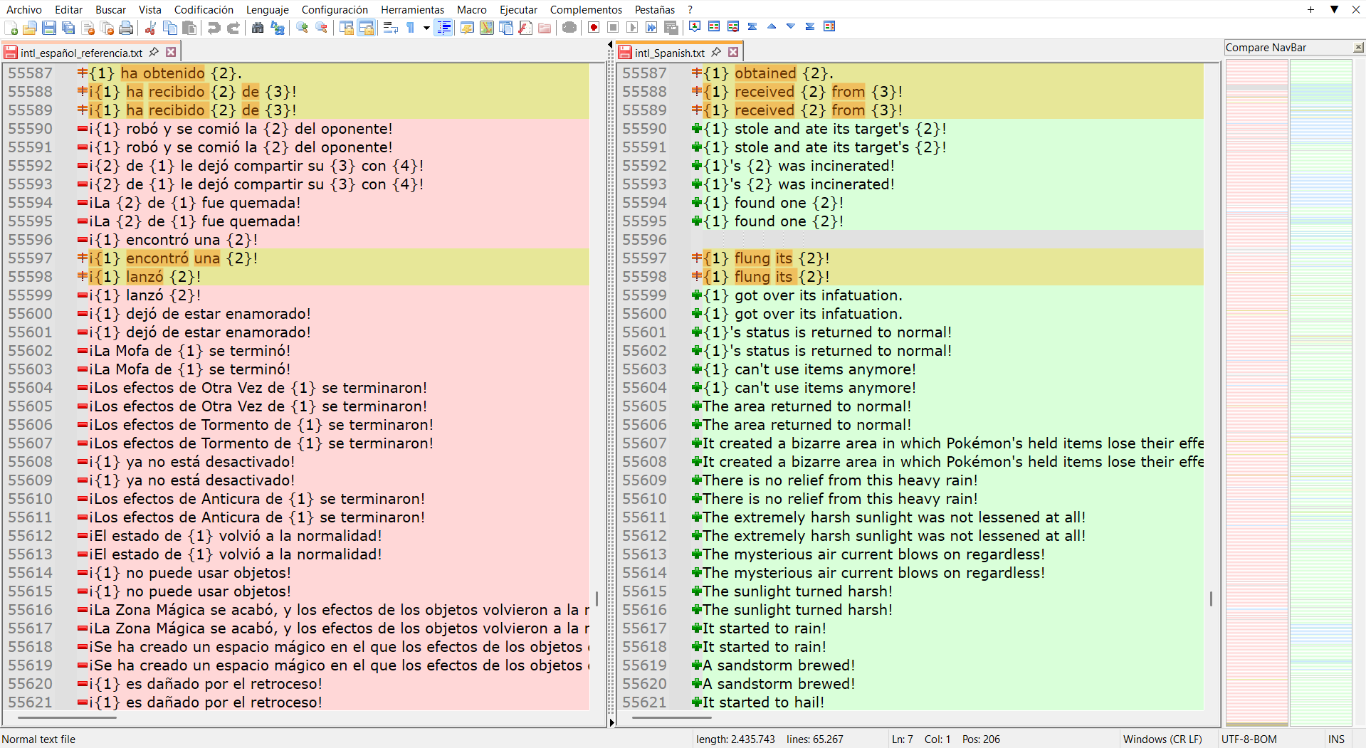

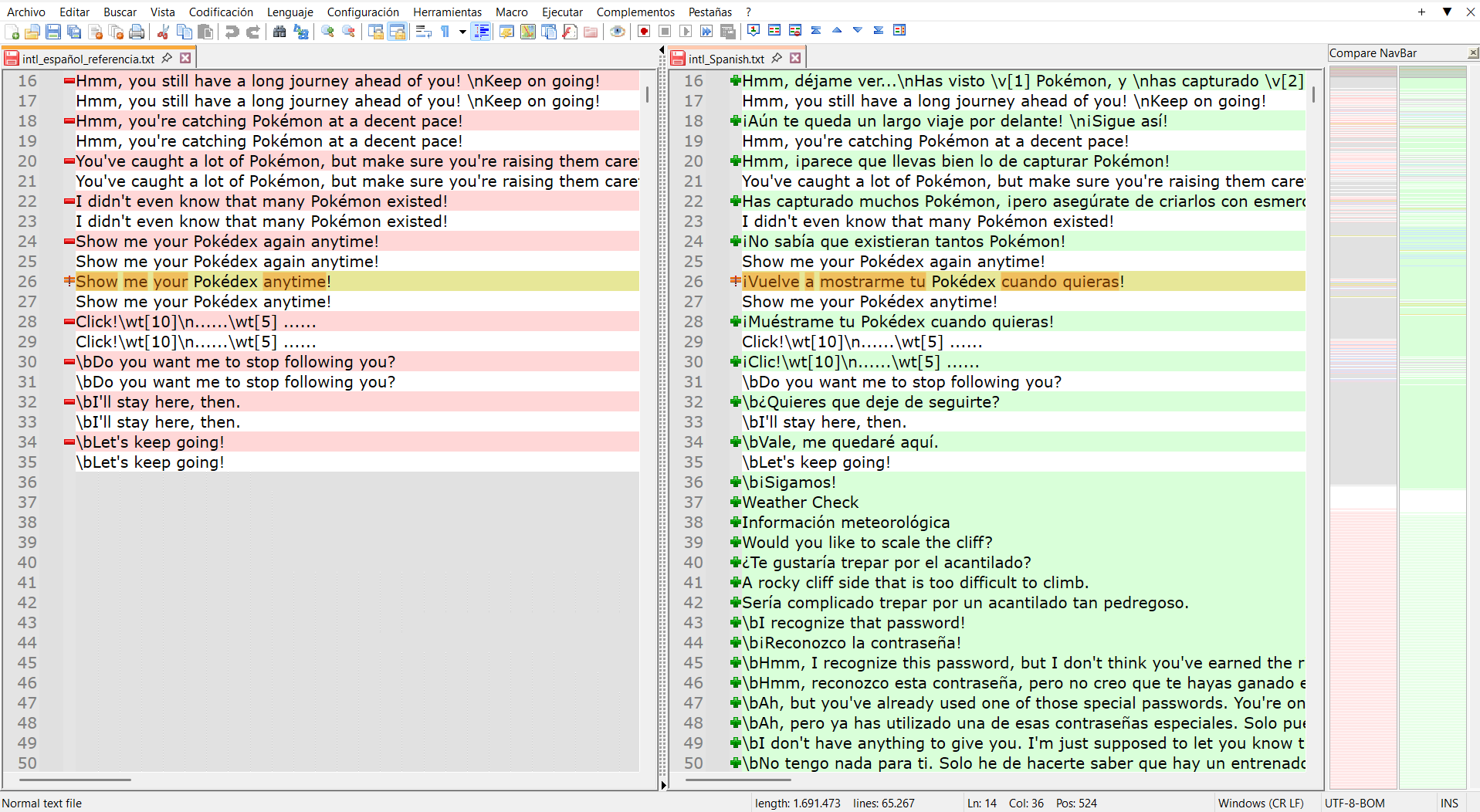

                  Here are some more screenshots of the documents:
                  These are the first lines, which I have translated, as you can see. Those on the right that don’t have a pair on the left are new, because they weren’t in the “base game”, and were introduced in the game I’m translating. Those new lines, I’ll translate them myself, no copypaste.
                  Then, we have these kind of lines:
                  They DO HAVE a pair, but they don’t match, so I would have to translate them myself, too, ignoring the lines on the left (the “base game”).
                  There’s also lines such as these:
                  They have pairs, and I would have to double-click the ones on the left and replace ONLY the second lines on the right with the ones I copied from the left (because, when you’re translating a game made in RPG Maker, and you wish to add a translation, only the second lines after the original ones count for the translated version).
                  So, what I am looking for is some (quick) method to replace the lines with pairs (like the ones on the last screenshot).
                  I must say, I do appreciate your replies, but I didn’t really understand them… It looks to me like advanced Notepad++ methods.
                  Thank you very much!

                    @Drakyem said in Replace multiple, alternate lines in a comparison of two files:
                    I don’t think there is a really quick method. If there are enough lines like this, it might be worth the trouble to use one of the methods suggested.

                      @Coises Thank you for your reply.
                      I understood your directions, and you understood what I’m trying to do, too.
                      BUT, I may have made a mistake by showing different examples with the same format, because the sections that I want to replace do not only come with numbers in it, and I’m going to show you right now:
                      It’s the exact same case, but without numbers. Also, some lines from the left side are not on the right side (see lines 55592 and 55593 on the left, for example).
                      In this case, lines 555596 and 55597 on the left side correspond to lines 55594 and 55595 on the right side.
                      Terry RT C 2 Replies Last reply May 29, 2025, 11:20 PM Reply Quote 0
                      • Terry RT
                        Terry R @Drakyem
                        I’ve been following some of this thread from the sidelines. And this latest snippet of information tells me that the goal of doing this with Notepad++ with any amount of tools or regexes is an exercise in futility.
                        Programs need a common reference in order to “combine” data. You now suggest that neither is guaranteed.

                                Left pane:
                                # To localize this text for a particular language, please
                                # translate every second line of this file.
                                [Map0]
                                ......\wt[5] ......
                                ......\wt[5] ......
                                Hello, \PN!\nI can see you calling me over there!
                                Hello, \PN!\nI can see you calling me over there!  <INSERTED>
                                Come over and talk to me.
                                [map1]
                                \c[2]Palmiro:</c> ¡Hemos terminado!
                                0
                                Bulbasaur
                                Bulbasaur  <INSERTED>
                                Ivysaur
                                Ivysaur
                                ¡Felicidades! Has completado {1}.
                                ¡Felicidades! Has completado {1}.  <INSERTED>
                                Added <INSERTED> to 3 lines to create differences like a language difference make it different.
                                Right pane:
                                [Map0]
                                ......\wt[5] ......
                                ......\wt[5] ......
                                [map1]
                                0
                                Bulbasaur
                                Bulbasaur
                                Ivysaur
                                Ivysaur

                                Result after running the script:
                                I enabled Change History to show in the lines and enabled End Of Lines to show to identify the affect of the modifications.
                                If inspected as not OK then it can be undone with pressing Ctrl+Z on the right pane.
