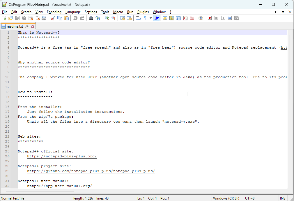

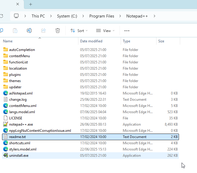

              • Chris GorringeC Offline
                Chris Gorringe
                Thanks both for your help but I still have the problem.
                I have unistalled NP++ and chose the option to delete my config which did delete all the files in my C:\Users\Chris\AppData\Roaming\Notepad++ folder. I then checked the folder where NP++ was installed (C:\Program Files\Notepad++) and the only file left was asNotepad.xml.
                I then reinstalled NP++ with default options and then within Explorer, I edited the readme.txt (“C:\Program Files\Notepad++\readme.txt”) with NP++. It opened successfully but showed the tab as well.
                My Debug info is this:
                Notepad++ v8.8.2 (64-bit)
                Build time : Jun 26 2025 - 01:12:36
                Scintilla/Lexilla included : 5.5.7/5.4.5
                Boost Regex included : 1_85
                Command Line : “C:\Program Files\Notepad++\readme.txt”
                Local Conf mode : OFF
                Cloud Config : OFF
                Periodic Backup : OFF
                Placeholders : OFF
                Dark Mode : OFF
                Display Info :
                visible monitors count: 1
                0001: Description - AMD Radeon ™ R9 M375
                0001: DriverVersion - 27.20.20903.8001
                0002: Description - Intel® HD Graphics 5500
                0002: DriverVersion - 20.19.15.4624
                0005: Description - Microsoft Remote Display Adapter
                0005: DriverVersion - 10.0.26100.1150
                0006: Description - Microsoft Remote Display Adapter
                0006: DriverVersion - 10.0.26100.3624
                - warning, search has been limited to maximum number of adapter records: 4
                OS Name : Windows 11 Pro (64-bit)
                OS Version : 24H2
                OS Build : 26100.4351
                Current ANSI codepage : 1252
                Plugins :
                NppConverter (4.6)
                Attached is an image of NP++ after the reinstall and another image shows the folder where NP++ is installed.NP++ after reinstall.png NP++ folder contents after reinstall.png

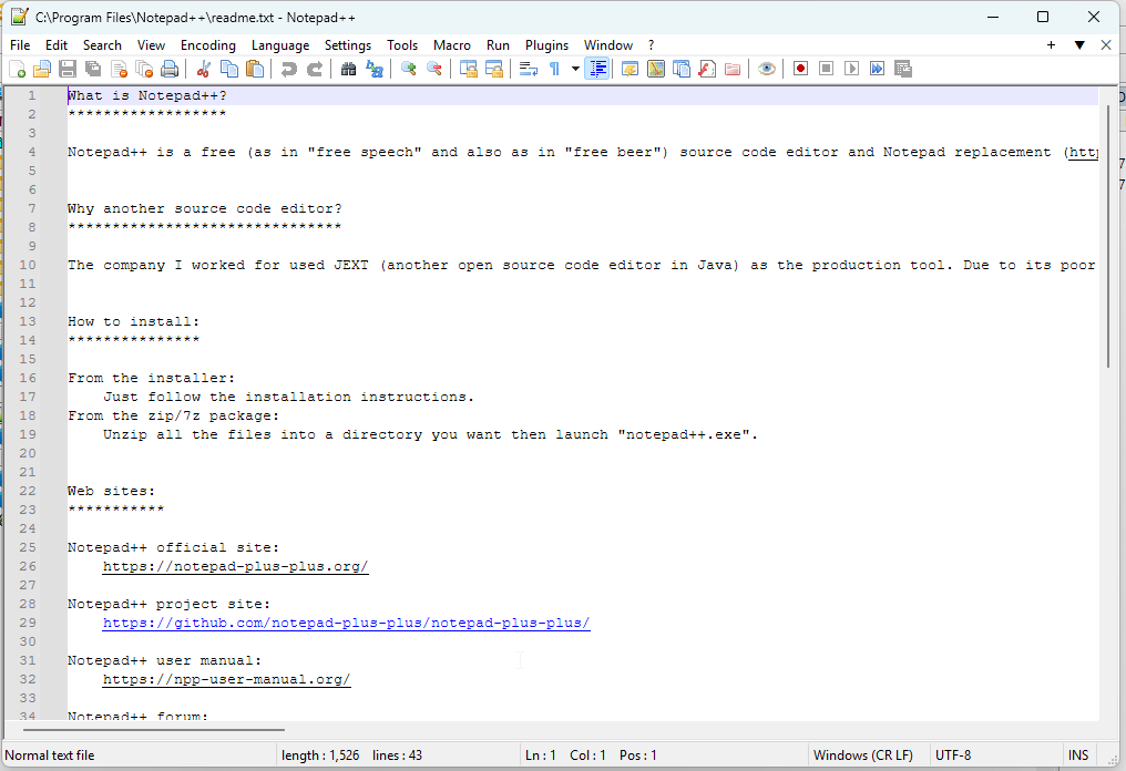

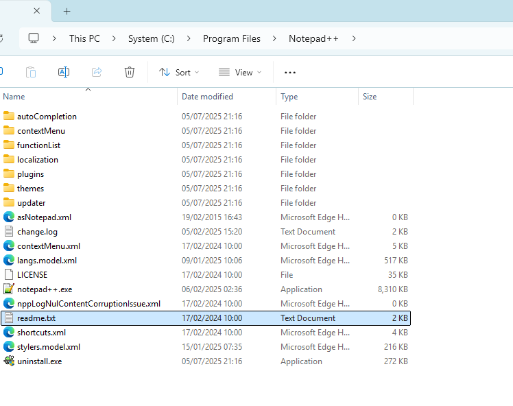

                  Chris Gorringe
                  If I then uninstall 8.8.2 and delete my settings again, followed by a fresh install of 8.7.7 and repeat the exact same process, it works correctly. Images attached
                  NP++ 8.7.7 after reinstall.png NP++ 8.7.7 folder contents after reinstall.png
                  And then if I uninstall 8.7.7 and reinstall 8.8.2, the problem then reappears as before.
                  I have also tested it by launching NP++ and the opening the readme.txt file from within NP but the problem still persists. Did this to eliminate and context menu launch parameter issues.
                  Not sure what I can do next to help you.
