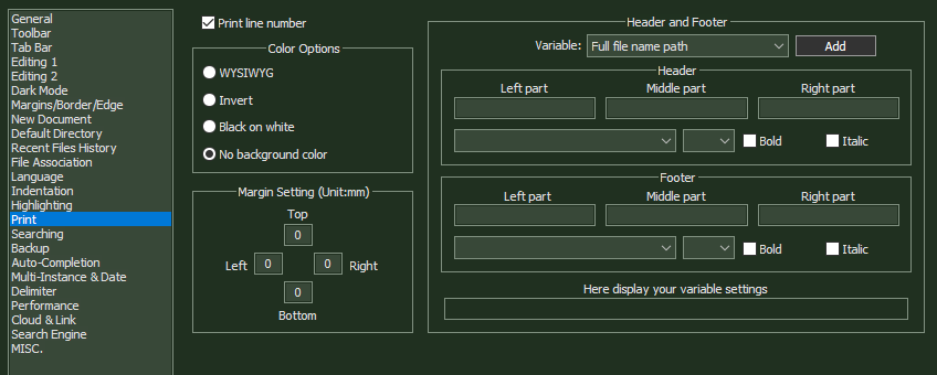

      My print settings are these:
      Alt text: Print Line Number is checkmarked but isn’t working, No background color, 0 margin, no header, no footer.
      Black and white was causing same issue a few days ago so I switched to no bg color and it happens with this too. The chance of this happening if I try to print multiple times in quick succession is very high. (e.g., tab1, print, tab2, print, tab3, print- freeze). I’m not sure if this is a Windows 10 22H2 problem or possibly a notepad++ problem. or a problem with the classic print dialog being used. or a problem with the way xerox interacts with the dialog interacts with notepad++

          @Terry-R Good ideas. I’ll just note that since changing to Adobe PDF, now trying to even select the Xerox printer freezes too.
          1. PDF print works, but line numbers were missing. FIXED: It’s because I had disabled Line #s in Margins/Border/Edge. Personally, those should be separate and not have this interaction., maybe I’ll try making a change request over the weekend.
