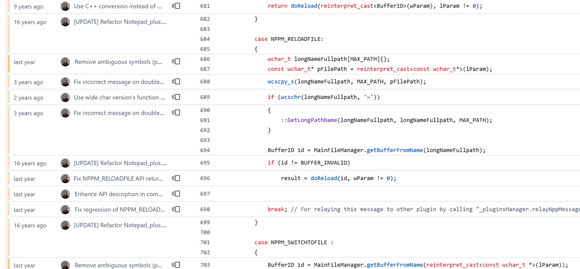

        Looks like the behavior of NPPM_RELOADFILE has been changed in either 8.8.5 or 8.8.4.
        Previously, NPPM_RELOADFILE activated the file being reloaded. In 8.8.5, the file is not activated.
        Is it intended?
          donho @Vitalii Dovgan
          @Vitalii-Dovgan
          I don’t think so.
          Here is git blame for the API you’re talking about:
          Obviously, the latest changing is the last year. So it was not changed in v8.8.4.
          BTW, you’re the only one (AFAICT) who complains this problem.
          If you find any issue, you’re welcome to create an issue on GitHub, and ping me - I’ll check it.
          Vitalii DovganV 1 Reply Last reply Reply Quote 0
          • Vitalii DovganV Offline
            Vitalii Dovgan @donho
            @donho
            Oh my God, you are right!
            Looks like NPPM_RELOADFILE has actually never activated the file being reloaded.
            The only change introduced in NPPM_RELOADFILE was between 8.6.4 and 8.6.5 where NPPM_RELOADFILE started to return TRUE on success. Previously it was always returning FALSE. And it was NppExec that activated the file when NPPM_RELOADFILE had returned FALSE.
            And all this time I’ve been mistakenly thinking that NPPM_RELOADFILE activates the file being reloaded.
            Actually, the following code in Notepad_plus::doReload seems to be related to activating the buffer, so I’m not sure what actually happens:
            if ( ((currentView() == MAIN_VIEW) && mainVisible) || ((currentView() == SUB_VIEW) && subVisible))
            	activateBuffer(id, currentView(), true);
                  @Vitalii-Dovgan said in Notepad++ v8.8.5 Release:
                  What happen is exactly as its comment:
                  	// Once reload is complete, activate buffer which will take care of
                  	// many settings such as update status bar, clickable link etc.

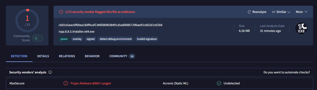

                            • B Offline
                              bao86
                              Hi,
                              VirusTotal is flagging v8.8.5 with the following:
                              Is this a concern or a false positive?
                              Thanks.
