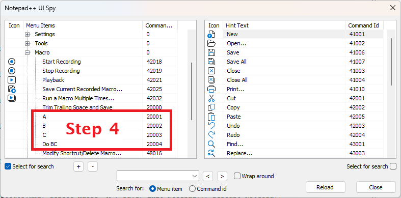

                  1. Start with three recorded macros (A,B,C, which just type the character of the name), restart
                  2. Use NppUISpy! to see that those macros are 20001, 20002, 20003
                  3. Manually edit a new macro called “Do BC” which calls B and C
                    <Macros>

                  4. Restart and use NppUISpy to see the new macro is 20004. (Verified the macro worked, typing BC)

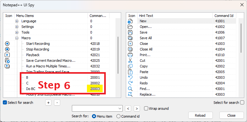

                  5. Edit shortcuts.xml, delete macro “A”, save, Exit Notepad++, restart Notepad++
                  6. See that NppUISpy now lists B as 20001 and C as 20002 and “Do BC” as 20003
                  7. Run “Do BC” and see it type C a number of times: it’s running 20002 to get “C”, then it runs 20003, which recursively calling itself until it hits an internal recursion limit
                  I tried this multiple times, in various combinations. It is 100% repeatable: it renumbered the macros every time one was inserted or deleted from the sequence, invalidating the wParam value used.
                  Like with the LF vs CRLF, I think you happened to be in the “lucky” circumstance where your experiment happened to work. In general, you cannot rely on the the menuCmdID for any given macro staying the same if you change the number or order of macros. Telling other people that it’s okay to rely on that is to tell them to invite disaster.
                  Hence, the FAQ will continue to state that if you change the number of Macros (Run commands, or add/remove/update plugins), you should always check to make sure the menu command ID hasn’t changed, otherwise your macro will quite possibly not do what was intended, once circumstances change.
                  ? 1 Reply Last reply Reply Quote 1
