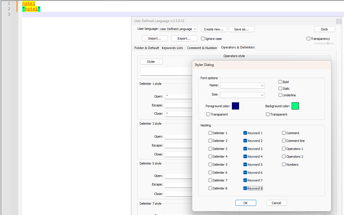

      I have been using UDL for long time for simple word highlighting. Now i come across text where words are enclosed in “”, like “note1”, and as it is in a CSV file, a line could be as:
      Note0,“note1”,“note2”,note3
      So any tips to how i get NP++ to catch e.g. “note1” here?
      br Lars

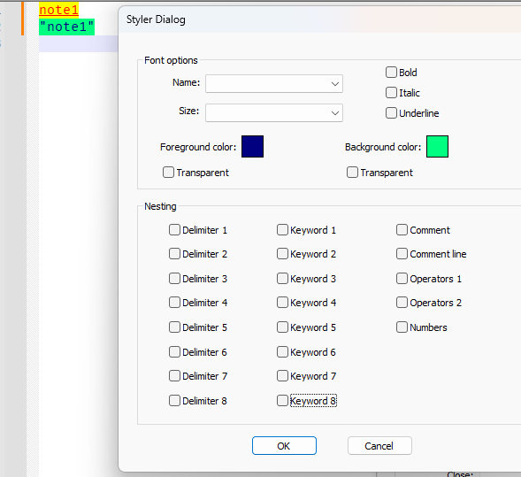

        If you set " as the open and close for a delimiter pair, and set that Delimiter # > Styler to allow nesting of the Keywords1 - Keywords8:
        if you don’t allow nesting then everything inside the quotes is colored as part of the quote:
        So, with
        • Ignore Case on
        • Keywords1 set to note0 note1 note2 note3 note4
        • Delimiter 1 set to open:" close:" and allowing nesting of keywords# inside
        I can get the following, which I believe is what you want:

          @PeterJones Exceptional, thanks for the help!
