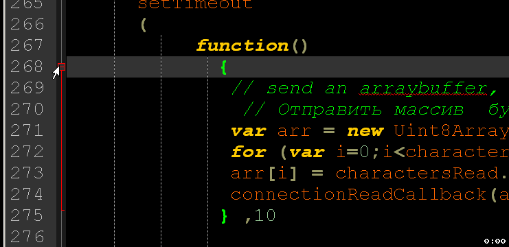

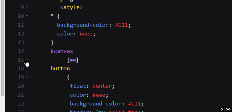

      How do I fold code while preserving closing tags and parentheses?
      The lone opening parenthesis sticking out looks strange to me.
      Notepad++
      like codepen

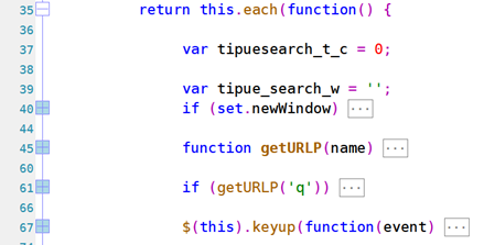

          Yes, alternative folding styles are possible. They just have to be implemented in the Notepad++ application code.
          According to the relevant Scintilla documentation:
          The marker numbers SC_MARKNUM_FOLDER and SC_MARKNUM_FOLDEROPEN are used for showing that a fold is present and open or closed. [M]ore assignments are needed for the flattened tree style: SC_MARKNUM_FOLDEREND, SC_MARKNUM_FOLDERMIDTAIL, SC_MARKNUM_FOLDEROPENMID, SC_MARKNUM_FOLDERSUB, and SC_MARKNUM_FOLDERTAIL.
          For example, the Notepad4 editor provides SC_MARKNUM_FOLDERTAIL as the default style, which creates the dotted boxes shown below:
          Mister SmittM 1 Reply Last reply Reply Quote 3

            This is the perfect option!
