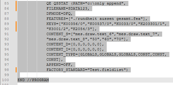

      Hello, I am new to this forum. I am working as an IT Administrator and use Notepad++ for a long time now. Now I need a solution for replaceing text blocks in a lot of measurement files. For this I added the ToolBucket Plugin. Here is my needed change (line 147 (in this file) always starts with QE QSSTAT, rest different):
      should be replaced by
      I tried now or 3 days, but no solution yet with regular expressions. 0 Matches or more that 200 (it is once in the file)
      Please help, thank you very much.

        If you need to replace only this line then default find and replace works fine.
        Ctrl+h and check regular expression
        Find: QE QSSTAT.*
        Replace: your content if its same

          Further to what @h-jangra said, since N++ v8.8.6, you can just paste your multi-line text into the Replace, and use the Search @h-jangra suggested, and you don’t need the plugin at all…
          If your replacement has parentheses () or dollar signs $, it might not work as you expect, so you might have to escape them, as described in the user manual (https://npp-user-manual.org/docs/searching/#substitutions)
