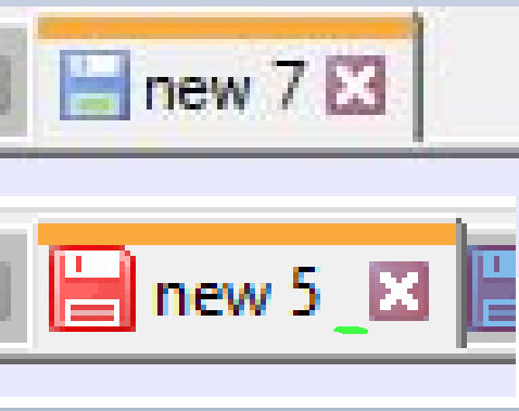

      So i updated for the first time after a couple of years, and i see that the width of some of my tabs almost doubled:
      which also means that the amount of tabs i can see at once almost halved, and thats no good.

          on the screenshot above Reduce option is already pressed though.
          Max tab label length truncates text, which is not the behavior i want to restore - i want the tabs with short names to not have this big gap at the end.
          That said, it seems that the “enable pin tab feature” was the culprit, as disabling it seems to have restored the desired tab size behavior.
          There still is some extra spacing before the close button though:
