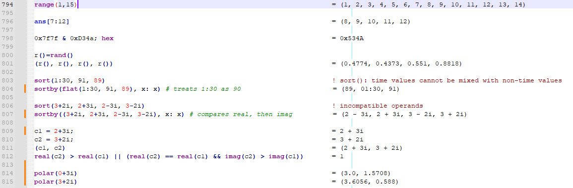

            A small example of what is already working:
            This demonstrates just several functions; the other functions from USAGE_AND_SYNTAX work as well.

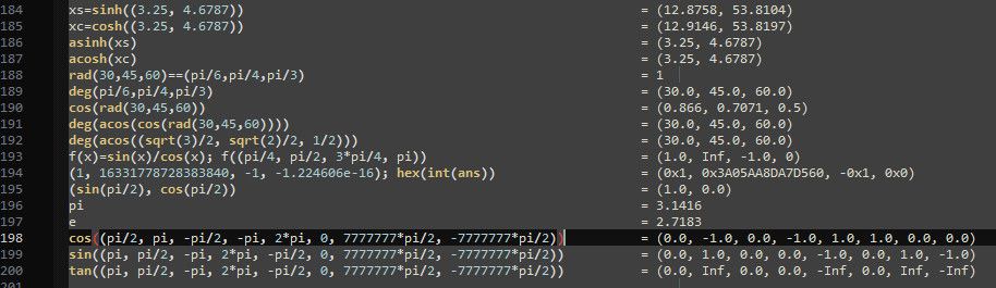

              Here is an example withUDL applied:
              It’s a pity that I can’t make the keyword colors (such as function colors) to be dependent on the active color theme/style.
              I mean, for dark color themes these keywords in blue look too dark, so the color must be changed for dark themes.

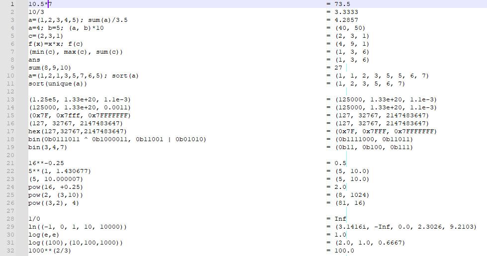

                Now the plugin supports the Dark Mode by means of “SmartMath_Dark.udl.xml” (in addition to “SmartMath.udl.xml” which is the light one) and automatically applies either light or dark one.
                This is achieved by listening to NPPN_DARKMODECHANGED and requesting NPPM_ISDARKMODEENABLED to understand whether the dark UDL or the bright UDL to apply.
                A screenshot:
                Feel free to propose better colors if you are good in that :)
                The UDLs are here:
