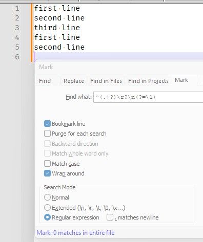

      I am using Notepad++ 32-bit 8.6.7 on Windows 10.
      I am trying to mark duplicate lines (not delete) in text documents. I am using Search Mode and Regular Expression, and have checked Bookmark Line and Mark All buttons.
      First, I entered the expression: ^(.*?)$\s+(?=[\s\S]*?^\1$) under the Mark tab. It said, “Find invalid regular expression”.
      Then, I tried: ^(.+?)\r?\n(?=\1) which found zero matches in entire file. I KNOW there is is at least one identical duplicate line.
      Anyone knows the correct way of doing this?

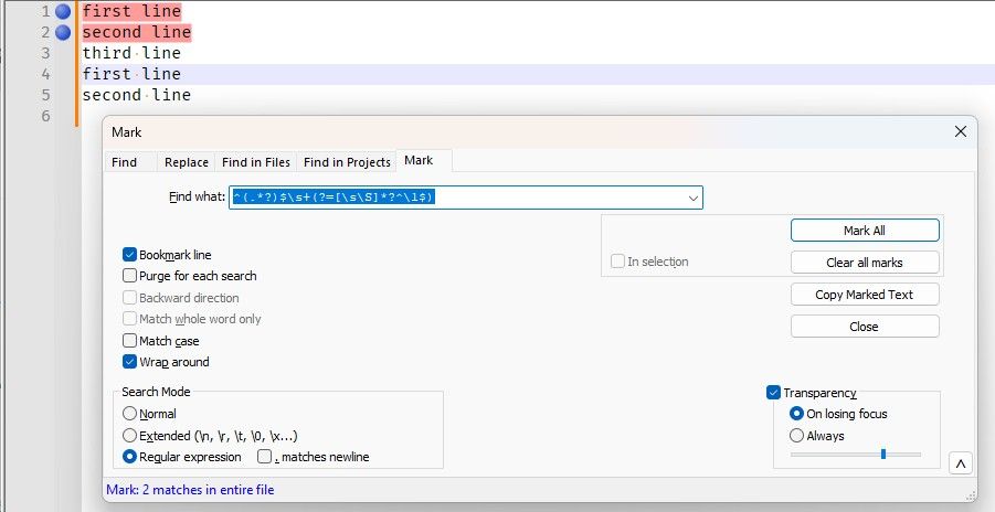

        Hover over the ... button in the speach bubble on the error message. It will tell you that, essentially, the regex got too “complex”, because it has to keep backing up to try the next option. Basically, your file is too big.
        See more in the User Manual on regex complexity
        With a small file, your regex works just fine:

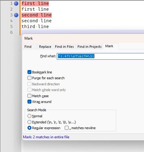

        That one only finds duplicate lines if they are immediately next to each other:
        vs
