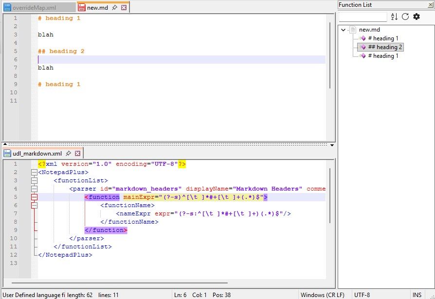

        PeterJones @behrouz1
        @behrouz1
        I will be assuming you have a normal installation (using AppData for configuration files). If that’s not the case, or you are having difficulty finding the files and directories mentioned, share your ?-menu’s Debug Info

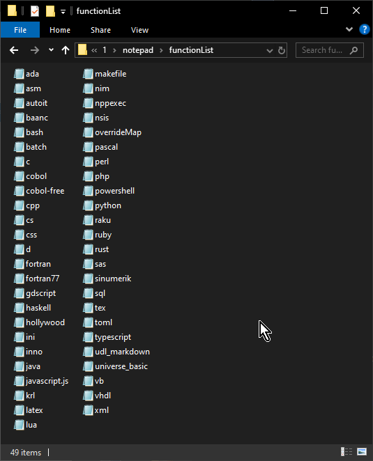

        • share a directory listing of %AppData%\Notepad++\functionList
          • you are looking for it to contain something like udl_markdown.xml or something similarly named. And a file called overrideMap.xml
        • open %AppData%\Notepad++\functionList\overrideMap.xml , and scroll down near the bottom; there should be a section <!-- ==================== User Defined Languages ============================ --> , and there should be some <association .../> tags there, including one like <association id="udl_markdown.xml" userDefinedLangName="Markdown (preinstalled)"/>.
          • If it’s not there, share the entire section from the “User Defined Languages” section down to the bottom. (Use </> button then paste the XML directly into your post in the region provided by the button)
        Even in a normal installation, if you did things differently (maybe your AI doesn’t know N++ as well as you think), those files may have been put into the installation directory, so in c:\program files\notepad++\functionList\ or wherever relative to your installed Notepad++.
        Basically, what you must have is that your overrideMap.xml must have an association where the filename is in the id attribute, and the exact name of the active UDL (in my case, I am using Markdown (preinstalled)) is in the userDefinedLangName attribute. Then that file must contain the definition for the function list to show the headers (if you can’t find those files anywhere, even after we reply to your Debug Info, then you might need to download a new definition file, like from my publically-shared one, here on my GitHub)

          Tanks for your help. I use portable version.I save all the useful texts I collect from the internet in .md files because they have headings. For example, after I find a solution to this problem, I save it in an .md file.

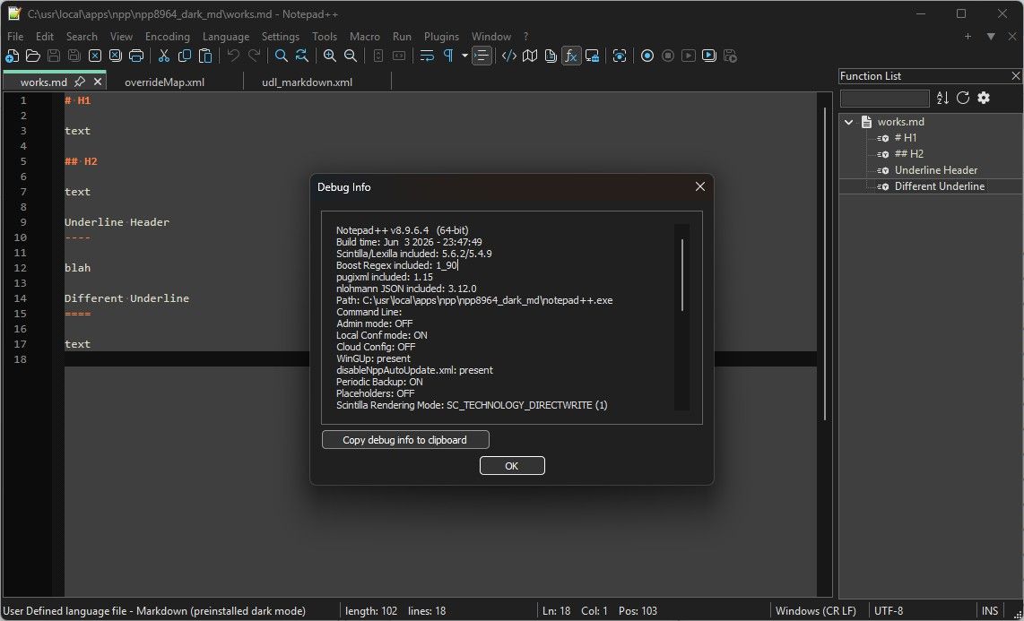

          Debug Info
          Notepad++ v8.9.6.4   (64-bit)
          Build time: Jun  3 2026 - 23:47:49
          Scintilla/Lexilla included: 5.6.2/5.4.9
          Boost Regex included: 1_90
          pugixml included: 1.15
          Path: C:\1\notepad\notepad++.exe
          Command Line:
          Admin mode: OFF
          Local Conf mode: ON
          WinGUp: present
          disableNppAutoUpdate.xml: present
          Periodic Backup: OFF
          Placeholders: OFF
          Dark Mode: ON
              primary monitor: 1600x900, scaling 100%
              visible monitors count: 1
                  0000: Description - NVIDIA GeForce GT 710
                  0000: DriverVersion - 30.0.14.7212
          OS Name: Windows 10 Enterprise LTSC 2021 (64-bit)
          OS Version: 21H2
          OS Build: 19044.7291
          Current ANSI codepage: 65001
              ComparePlugin (2.0.2)
              DSpellCheck (1.5)
              EnhanceAnyLexer (1.4.1)
              PythonScript (2.1)

          directory listing of unctionList
            @behrouz1 ,
            All your setup – directories, file names, and the overrideMap association – look right.
            It looks like your function list regex can be slightly modified to make it work.
            The .* from ^[\t ]*#+[\t ]+(.*)$ is matching across multiple lines, because the default for the .-matches-newline switch in the regex engine is “on”. Using (?-s) or equivalent is highly recommended for the function name matching.
            So with that slight tweak, I was able to make yours work:
            <?xml version="1.0" encoding="UTF-8"?>
            <NotepadPlus>
                <functionList>
                    <parser id="markdown_headers" displayName="Markdown Headers" commentExpr="">
                        <function mainExpr="(?-s)^[\t ]*#+[\t ]+(.*)$">
                            <functionName>
                                <nameExpr expr="(?-s:^[\t ]*#+[\t ]+)(.*)$"/>
                            </functionName>
                        </function>
                    </parser>
                </functionList>
            </NotepadPlus>
            You also might want to try mine (linked above), because it also handles “underlined header” syntax, like:
            This is a header
            blah
            So is this
            And those “underlined header” syntaxes are recognized by many markdown parsers (including the one for this forum).
            B 1 Reply Last reply Reply Quote 0
                        @behrouz1 ,
                        I cannot see what’s going wrong. It all works perfectly when I set things up for myself, as decribed in the conversation above. My guess is there’s been a miscommunication or misunderstanding at some point.
                        Here is a zip archive of a portable 8.9.6.4 set in Dark Mode:
                        • (http://pryrt.com/nppxml/npp8964_dark_md.zip). The zipfile will only be there for a few days, then I will delete this link.
                        Download it. Look at the mentioned files and filestructure. Compare what’s wrong in yours compared to this working example.
