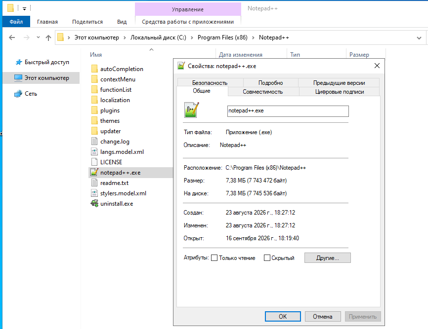

              2. use Windows Explorer to go to c:\myportable\notepad++\
              3. right click on notepad++.exe,
                • select Properties,
                • be on the General tab (which is the first tab you should see).
                • Look at the bottom.
                • Does it have the “Unblock” checkbox at the bottom, like in the following screenshot?
                  • If so, click the checkbox and choose Apply then OK

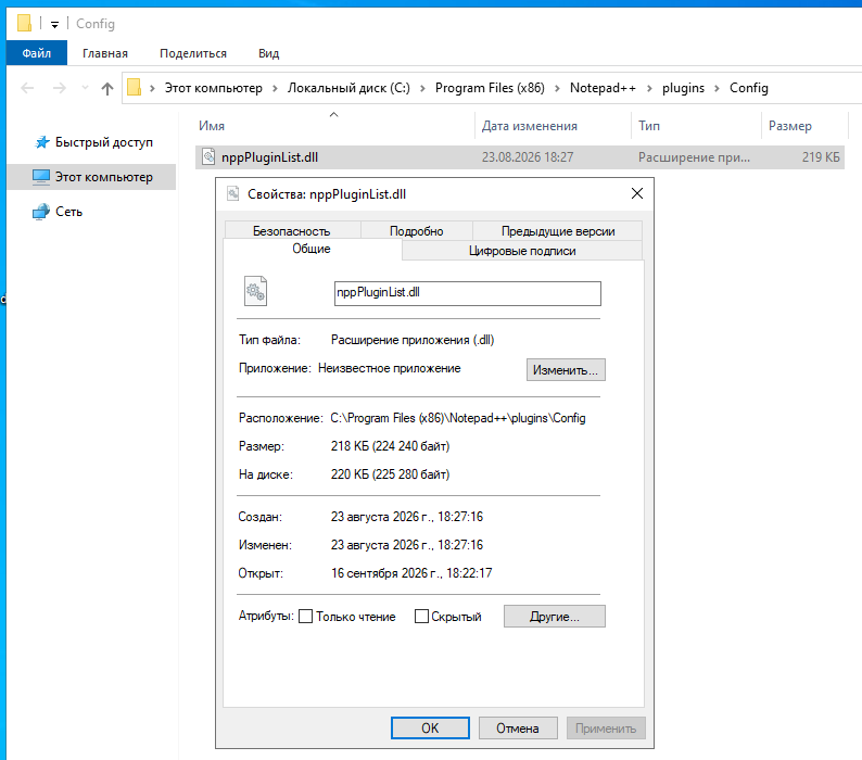

              6. use Windows Explorer to go to c:\myportable\notepad++\plugins\Config\
              7. right click on nppPluginList.dll,
                • Does it have the “Unblock” checkbox at the bottom?

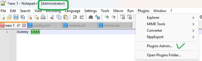

              Now, run Notepad++ again. Plugins Admin should show up in the Plugins menu
              If it does not, you need to do the following:

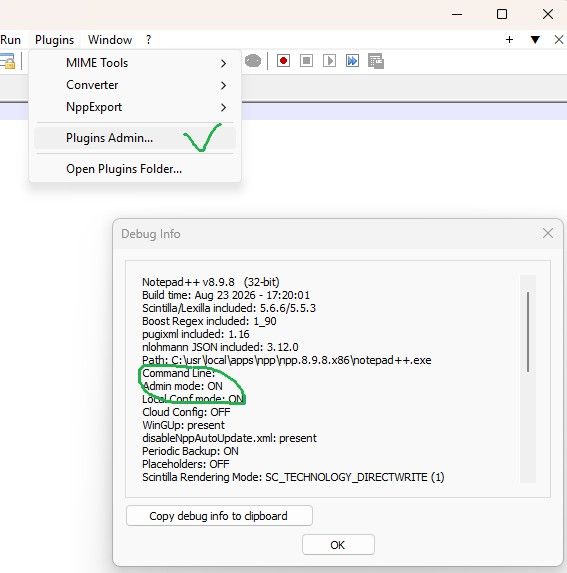

              • Share your ?-menu’s Debug Info
              • Share a screenshot of your Plugins menu
                • not a movie
                • please do a normal screenshot, so you can paste it right in your post, so we can see it withouth going to an external website who exists solely to show us ads we don’t want.
                • it should be something like this:

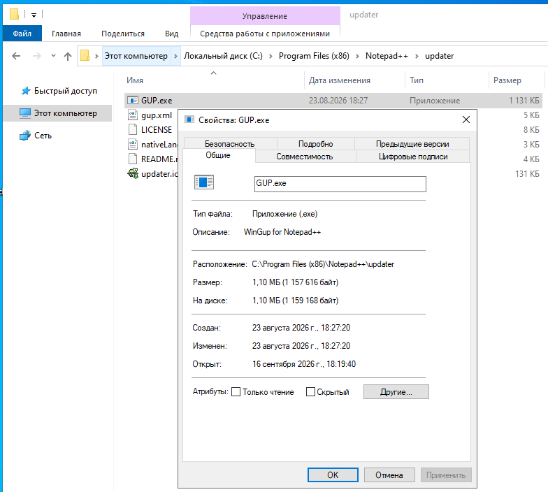

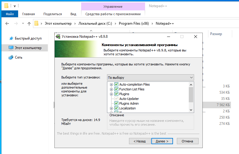

              • A Online
                andrecool-68 @PeterJones

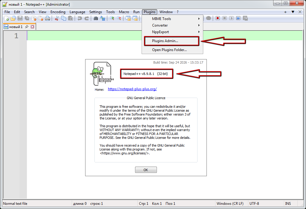

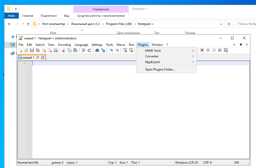

                Did a clean install on a virtual machine with Windows 10
                Notepad++ v8.9.8 (32-bit)
                Build time: Aug 23 2026 - 17:20:01
                Scintilla/Lexilla included: 5.6.6/5.5.3
                Boost Regex included: 1_90
                pugixml included: 1.16
                Path: C:\Program Files (x86)\Notepad++\notepad++.exe
                Command Line:
                Admin mode: ON
                Local Conf mode: OFF
                WinGUp: present
                Periodic Backup: ON
                Placeholders: OFF
                Dark Mode: OFF
                primary monitor: 1920x1007, scaling 100%
                visible monitors count: 1
                0000: Description - VirtualBox Graphics Adapter for Windows 8+
                0000: DriverVersion - 5.2.44.0
                OS Name: Windows 10 Enterprise LTSC 2021 (64-bit)
                OS Version: 21H2
                OS Build: 19044.1288
                Current ANSI codepage: 1251
                NppConverter (4.7)
