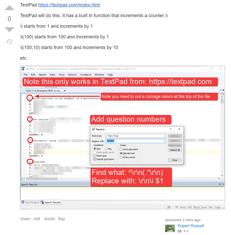

    • Rupert RussellR Offline
      Rupert Russell
      I ended up using TextPad it would be nice if Notepad ++ could also do this
