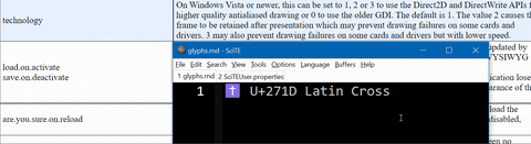

                The GIF below uses the SciTE text editor for demonstration (since modified settings have immediate effect); Notepad++ uses the same editing component and should behave identically, mutatis mutandis:
                Richard J OtterR 1 Reply Last reply Reply Quote 0

                    On a second look, it seems DirectWrite has no effect on DejaVu Sans Mono (maybe because it’s open source?). By contrast, every Microsoft font displays the “emoji” style with D2D switched on. It’s most likely a quirk in Scintilla (the editing component).
